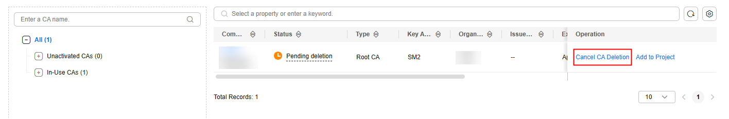

  3. Locate the row of the desired private CA and click Cancel CA Deletion in the Operation column.
    Figure 1 Canceling the deletion of a private CA
  4. In the displayed dialog box, click OK.
    If message "Deletion of CA xxx cancelled successfully." is displayed in the upper right corner of the page and the private CA status changes to Disabled, the deletion of the private CA is cancelled successfully.
