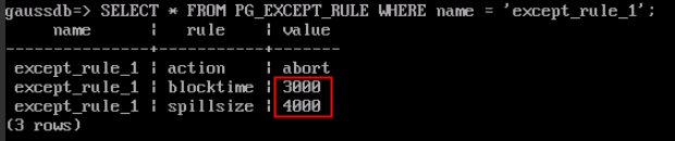

Change the blocktime threshold of exception rule set except_rule1 to 3000s and the space for spilled data to 4000 MB.
ALTER EXCEPT RULE except_rule_1 WITH (blocktime=3000, spillsize=4000);
Check whether the exception rule is modified successfully by querying the PG_EXCEPT_RULE system catalog.
SELECT * FROM PG_EXCEPT_RULE WHERE name = 'except_rule_1';

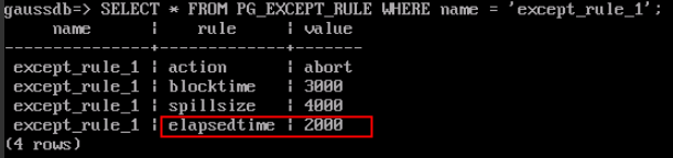

Add a new rule, that is, the maximum job execution time (elapsedtime) is 2000 seconds.
ALTER EXCEPT RULE except_rule_1 WITH (elapsedtime=2000);
Check the exception rule again. The rule is modified successfully. Note that the original rule is retained instead of being cleared.
