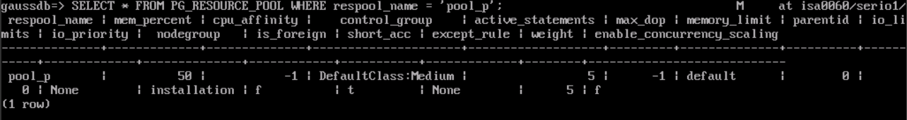

  • Query the configuration parameters of the resource pool in the PG_RESOURCE_POOL system catalog.
    SELECT * FROM PG_RESOURCE_POOL WHERE respool_name = 'pool_p';
