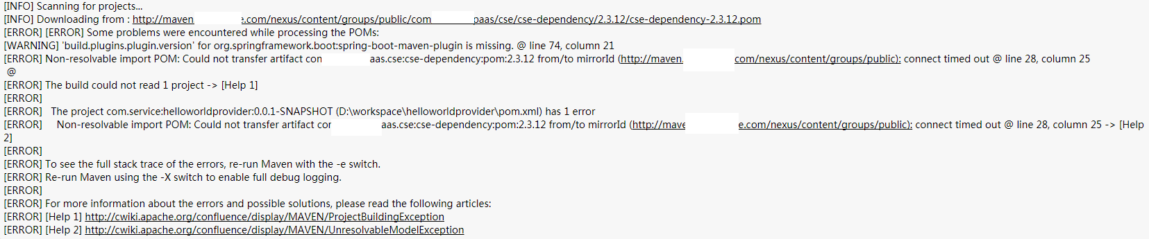

When the Maven image source is configured, the dependency fails to be obtained, as shown in Figure 1.
Figure 1 Failed to obtain the dependency
If you need to use a proxy to access the external network, configure the Maven proxy. Specifically, configure a proxy in the setting.xml file (user configuration) in the m2 directory in the user directory (for example, C:\Users\yang****\ in the Windows OS) or the setting.xml file (system global configuration) in the conf directory in the Maven installation directory.
Find the tags in the setting.xml file and configure the proxy information, as shown in the following example.
