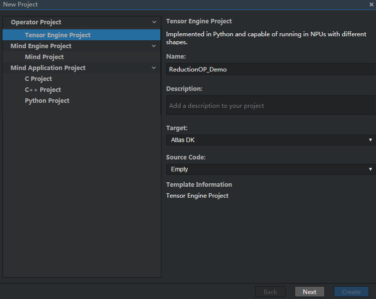

This mode depends on Mind Studio. The following figure shows the operation entry. |
The framework code is automatically generated based on the model file imported during project creation and selected operators. You only need to pay attention to the operator implementation code. |
The Makefile file does not need to be compiled because it is generated based on the configurations on Mind Studio. |
Ascend 310 TE Custom Operator Development Guide (Mind Studio) |
