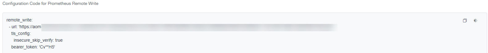

    3. On the displayed page, choose Settings in the navigation pane and click on the right to copy the configuration code for Prometheus remote write from the Service Addresses area.
      Figure 1 Configuration code for Prometheus remote write

    2. Add the configuration code for Prometheus remote write obtained in 3 to the end of the prometheus.yml file.
    The following shows an example. You need to configure the italic part.

    # Replace the italic content with the configuration code for Prometheus remote write obtained in 3.
    remote_write:
      - url:'https://aom-**.***.{Site domain name suffix}:8443/v1/6d6df***2ab7/58d6***c3d/push'
        tls_config:
          insecure_skip_verify: true
        bearer_token: 'SE**iH'
