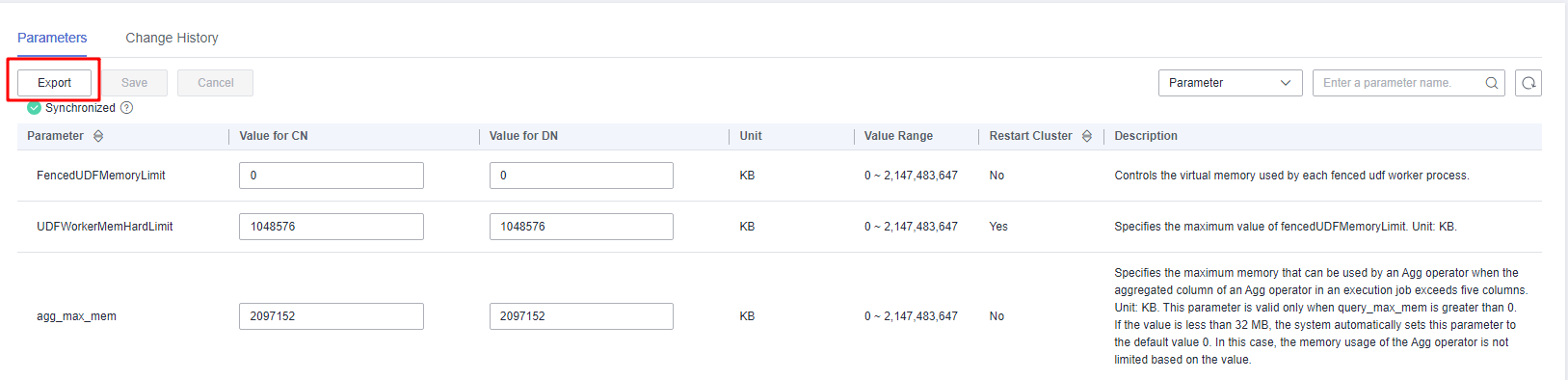

Exporting the Parameter List
  1. Log in to the GaussDB(DWS) console.
  2. Choose Dedicated Clusters > Clusters in the navigation pane.
  3. In the cluster list, find the target cluster and click the cluster name. The Cluster Information page is displayed.
  4. Click Parameters and click Export. You can export cluster configuration parameters.
    Figure 1 Exporting parameter settings
