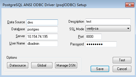

  4. Configure a data source to be connected to.
    1. On the User DSN tab, click Add and choose PostgreSQL Unicode for setup.
      Figure 1 Configuring a data source to be connected to
      You can view the values of Server and Port on the GaussDB(DWS) console. Log in to the GaussDB(DWS) console and click Client Connections. In the Data Warehouse Connection String area, select the target cluster and obtain Private Network Address or Public Network Address. For details, see Obtaining the Connection Address of a GaussDB(DWS) Cluster.
    2. Click Test to verify that the connection is correct. If Connection successful is displayed, the connection is correct.
