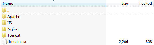

    1. Decompress the downloaded certificate file on your local PC.
      The downloaded file contains the Apache, IIS, Nginx, and Tomcat folders as well as the domain.csr file. Figure 1 shows an example.
      Figure 1 Decompressing an SSL certificate package on a local computer
    2. Obtain the SSL certificate file Certificate ID_Domain name bound to the certificate_server.pfx and password file Certificate ID_Domain name bound to the certificate_keystorePass.txt from Certificate ID_Domain name bound to the certificate_IIS.

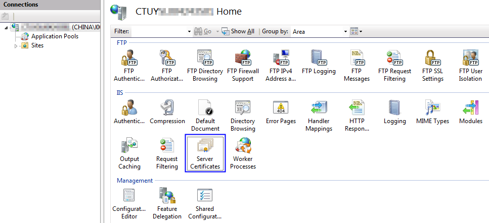

  2. Open the IIS management console, double-click Server Certificates.
    Figure 2 Double-clicking Server Certificates

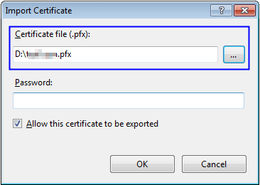

  3. In the displayed dialog box, click Import.
    Figure 3 Import
  4. Import the server.pfx certificate file. Then click OK.
    In the Password box, enter the password provided in the keystorePass.txt file.
    Figure 4 Importing a PFX certificate file

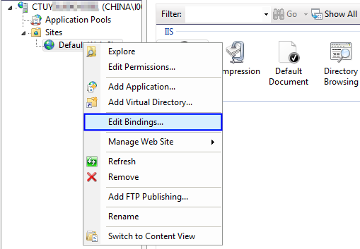

  5. Right-click the target site (the default site is used as an example). Choose Edit Bindings from the shortcut menu.
    Figure 5 Choosing Edit Bindings
