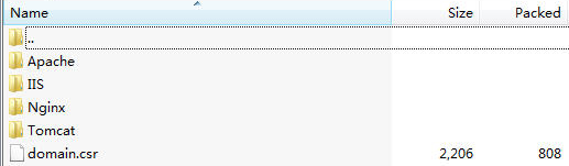

    1. Decompress the downloaded certificate file on your local PC.
      The downloaded file contains the Apache, IIS, Nginx, and Tomcat folders as well as the domain.csr file. Figure 1 shows an example.
      Figure 1 Decompressing an SSL certificate package on a local computer
    2. Obtain the certificate files Certificate ID_Domain name bound to the certificate_ca.crt and Certificate ID_Domain name bound to the certificate_server.crt, and private key file Certificate ID_Domain name bound to the certificate_server.key from Certificate ID_Domain name bound to the certificate_Apache.
