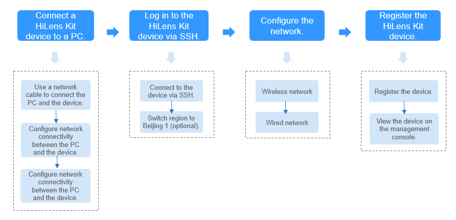

Registering a Device Using SSH
This option allows you to register a HiLens Kit device by logging in to the HiLens Kit system over SSH, running Linux commands, and modifying system configuration files.
Figure 1 shows the registration procedure. Table 1 describes the procedure in detail.
        Procedure  |
        Description  |
        Instructions  |
        Connect a HiLens Kit device to your local PC.  |
        The first thing you should do is to connect your HiLens Kit device to your PC and upgrade the system firmware to version 2.2.200.011.  |
        Connecting a HiLens Kit Device to a PC  |
        Configure the network.  |
        Configure a wireless or wired network to connect the device to the router. You can only connect your device to a router through a wireless or wired network. If you use a wireless network, the default gateway will be automatically deleted. You need to reconfigure the default gateway when you plan to use a wired network for connection. It is recommended that you use a wireless network. In this way, you do not need to remember the device IP address.  |
        "User Guide > Wireless Network Configuration" User Guide > Wired Network Configuration  |
        Register the HiLens Kit device.  |
        Register the device with the console and check the device status on the console.  |
