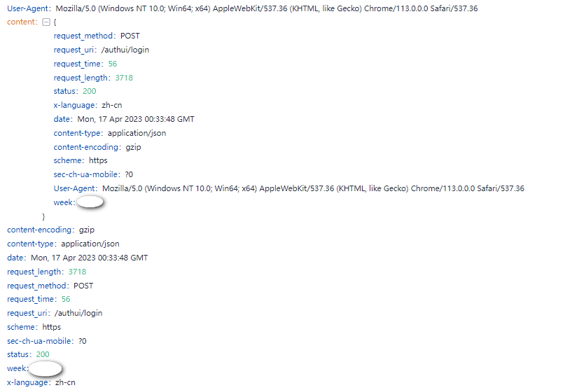

Example
Search Requirement |
Search Statement |
Logs in which the value of User-Agent contains the phrase Mon, 17 Apr 2023. |
User-Agent:#"Mon, 17 Apr 2023" |
Logs in which the value of User-Agent contains the phrase Mozilla/5.0. |
User-Agent:#"Mozilla/5.0" |
Logs in which the value of week contains the phrase Monday. |
week:#"Monday" |
