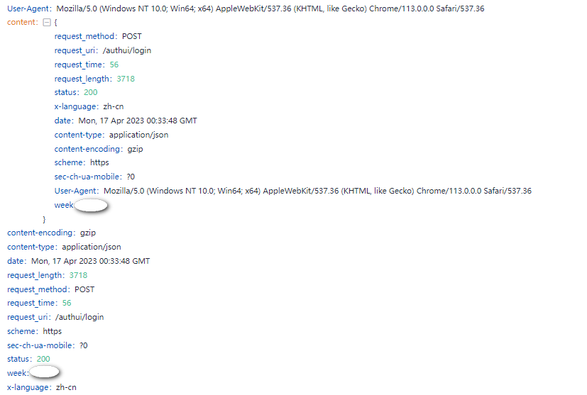

Logs whose sec-ch-ua-mobile field is ?0 |
sec-ch-ua-mobile:#"?0"
NOTE:
If search is required when log content contains asterisks (*) or question marks (?), use phrases search. |

Search based on delimiters. For example, the value of the User-Agent field is Mozilla/5.0 (Windows NT 10.0; Win64; x64) AppleWebKit/537.36 (KHTML, like Gecko) Chrome/113.0.0.0 Safari/537.36.
- If this parameter is left blank, the value of this field is considered as a whole. In this case, when you use User-Agent:Chrome to search for logs, no log can be found.
- When the delimiter is set to , '";=()[]{}?@&<>/:\n\t\r, the value of this field is split into Mozilla, 5.0, Windows, NT, 10.0, Win64, x64, AppleWebKit, 537.36, KHTML, like, Gecko, Chrome, 113.0.0.0, Safari, and 537.36.
Then you can use search statements such as User-Agent:Chrome for search.
