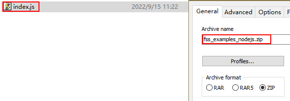

  2. Package the function project. The following uses an async handler as an example.
    After creating the function project, you get the following directory. Select all files under the directory and package them into the fss_examples_nodejs.zip file. Ensure that the function handler is under the root directory after the ZIP file is decompressed.
    You can also download the Node.js function sample project package and use it directly.

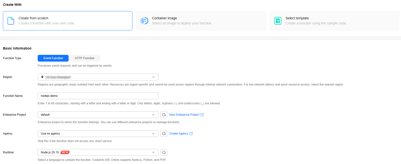

  1. Log in to the FunctionGraph console and click Create Function in the upper right corner.
  2. Create a Node.js event function from scratch and click Create Now as shown in Figure 2. The function details page is displayed.
    Figure 2 Creating a Node.js function

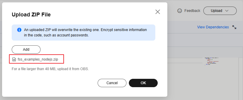

  3. Upload the fss_examples_nodejs.zip file packed in Step 1: Creating a Node.js Function Project by clicking Upload > Local ZIP, as shown in Figure 3.
    The uploaded code will be automatically deployed on the FunctionGraph console. If you have modified the code, click Deploy again.
    Figure 3 Uploading the code package

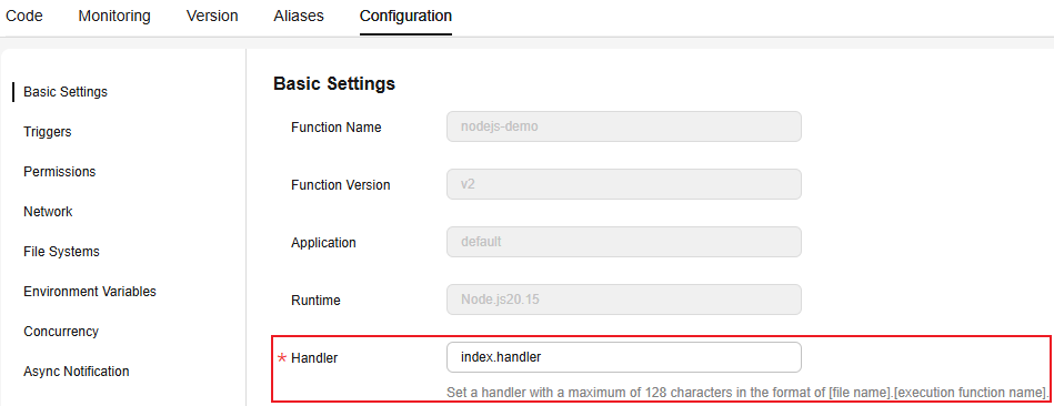

Modifying the function handler:
In the navigation pane on the left of the FunctionGraph console, choose Functions > Function List. Click the name of the function to be set. On the function details page that is displayed, choose Configuration > Basic Settings and set the Handler parameter, as shown in Figure 4.
Figure 4 Handler parameter

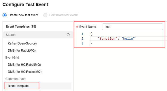

  1. On the Code tab, click Test. In the Configure Test Event dialog box, set test, as shown in Figure 5, and click Create.
    Figure 5 Configuring a test event
  2. Select the configured test event test and click Test.

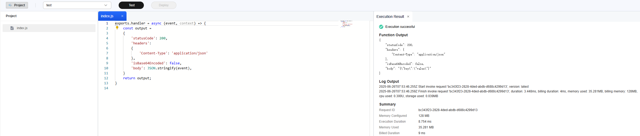

  3. As shown in Figure 6, the Execution Result window is displayed on the right. You can check whether the function is executed successfully.
    Figure 6 Test result
