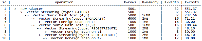

The original statement is as follows:
1 | explain select * from t3, (select a1,b2,c1,d2 from t1,t2 where t1.a1=t2.a2) s1 where t3.b3=s1.b2; |

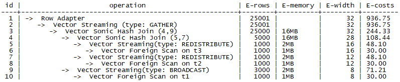

In this query, you can use the following methods to disable the pull-up of subquery s1:
- Method 1:
1explain select /*+ no merge(s1) */ * from t3, (select a1,b2,c1,d2 from t1,t2 where t1.a1=t2.a2) s1 where t3.b3=s1.b2;
- Method 2:
1explain select * from t3, (select /*+ no merge */ a1,b2,c1,d2 from t1,t2 where t1.a1=t2.a2) s1 where t3.b3=s1.b2;
Outcome:
