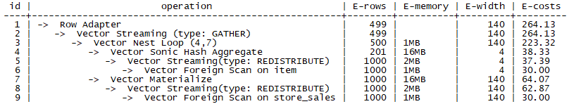

explain select /*+nestloop(store_sales tt) */ * from store_sales where ss_item_sk in (select /*+blockname(tt)*/ i_item_sk from item group by 1); |
tt indicates the sublink block name. After being pulled up, the sublink is joined with the outer-query table store_sales by using nestloop. The optimized plan is as follows:
