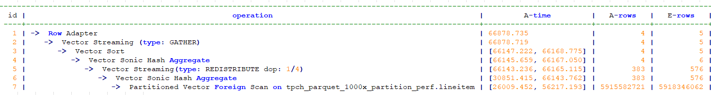

A query statement requires passing through multiple operator steps before producing the final result. It is quite common for the overall query performance to degrade due to certain operators taking excessively long times. These operators become the bottlenecks of the entire query. To fix this, you can run the EXPLAIN ANALYZE or PERFORMANCE command to find the bottleneck.
As illustrated in the following execution details, the HashAgg operator's execution duration constitutes (66167 – 56217)/66878 = 14.8% of the total time, while the Foreign Scan operator takes up 56217/66878 = 84% of the total time. Here, the Foreign Scan operator emerges as the bottleneck for this particular query. When optimizing performance, priority should be given to enhancing this operator, such as using partitioned tables.
