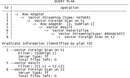

      The execution plan is as follows:
      2
      3
      4
      explain (costs off)
      select (select c2 from t2 where t1.c1 = t2.c1) ssq, t1.c2
      from t1
      where t1.c2 > 10;
      The correlated subquery is displayed in the target list (query return list). Values need to be returned even if the condition t1.c1=t2.c1 is not met. Therefore, use a left outer join to join t1 and t2 so that the SSQ can return padding values when the condition t1.c1=t2.c1 is not met.

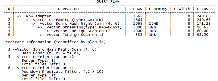

      The preceding SQL statement can be changed into:
      2
      3
      4
      5
      6
      7
      with ssq as
          select t2.c1, t2.c2 from t2
      select ssq.c2, t1.c2
      from t1 left join ssq on t1.c1 = ssq.c1
      where t1.c2 > 10;
      The execution plan after the change is as follows:
      In the preceding example, the SSQ is pulled up to right join, preventing poor performance caused by the combination of a subplan and broadcast when the table (T2) in the subquery is too large.

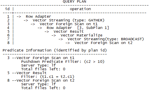

      The correlated subquery is displayed in the target list (query return list). Values need to be returned even if the condition t1.c1=t2.c1 is not met. Therefore, use a left outer join to join t1 and t2 so that the SSQ can return padding values when the condition t1.c1=t2.c1 is not met. However, COUNT is used, which requires that 0 is returned when the condition is not met. case-when NULL then 0 else count(*) can be used.

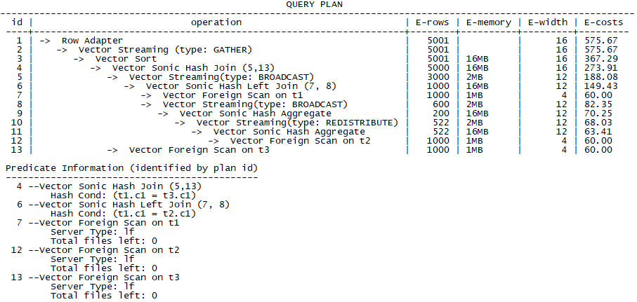

       2
       3
       4
       5
       6
       7
       8
       9
      10
      11
      with ssq as
          select count(*) cnt, c1 from t2 group by c1
      select case when
                  ssq.cnt is null then 0
                  else ssq.cnt
             end cnt, t1.c1, t3.c1
      from t1 left join ssq on ssq.c1 = t1.c1,t3
      where t1.c1 = t3.c1
      order by ssq.cnt, t1.c1;

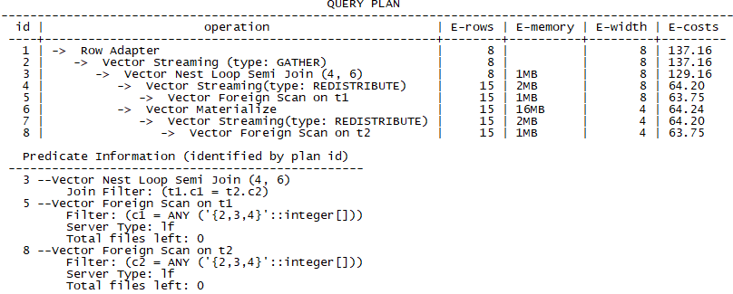

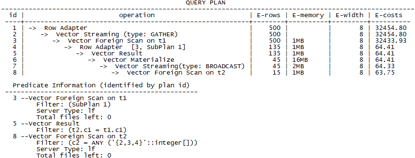

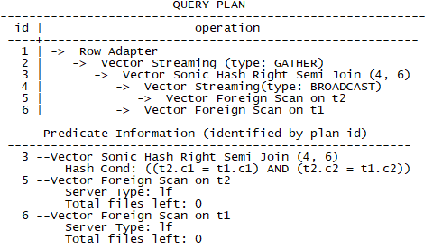

Example: Modify the SELECT statement by changing the subquery to a JOIN relationship between the primary table and the parent query or modifying the subquery to improve the query performance. Ensure that the subquery to be used is semantically correct.
explain (costs off)select * from t1 where t1.c1 in (select t2.c1 from t2 where t1.c2 = t2.c2);
In the preceding example, a subplan exists in the plan. To delete the subplan, modify the statement as follows:
explain(costs off) select * from t1 where exists (select 1 from t2 where t1.c1 = t2.c1 and t1.c2 = t2.c2);
In this way, the subplan is replaced by the semi-join between the two tables, significantly improving the execution efficiency.
