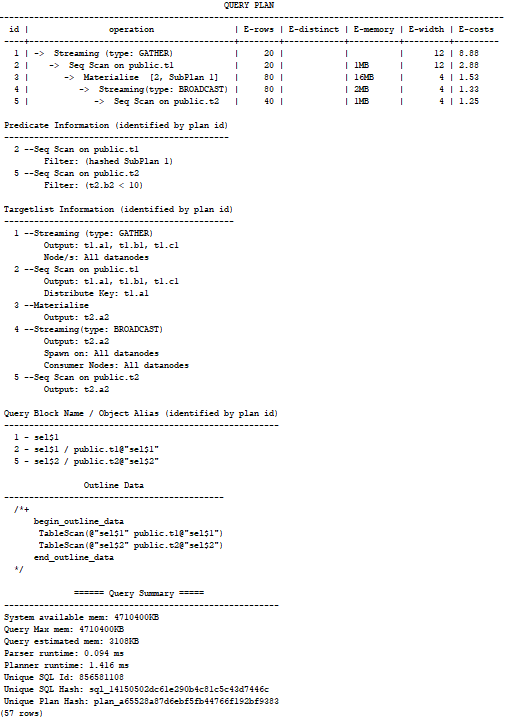

  11. View the plan of the statements that contain no merge hint.
    EXPLAIN (verbose on, blockname on, outline on) select * from t1 where a1 in (select /*+ no merge */ a2 from t2 where b2 < 10);
  12. View the plan for statements that does not contain no merge hint.
    EXPLAIN (verbose on, blockname on, outline on) select * from t1 where a1 in (select a2 from t2 where b2 < 10);

  15. Apply the attached outline to a statement without no merge hint. The subquery remains promoted.

  18. Apply the attached outline to a statement without no merge hint. Now, the subquery stays unpromoted.
