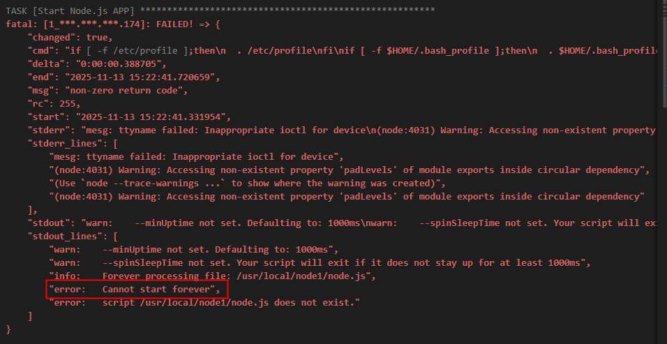

Symptom 1
The command for starting the Start/Stop Node.js action fails, and the error message Cannot start forever is displayed.
Cause Analysis
The log information indicates that the service cannot be started because the startup file is not found in the service path.

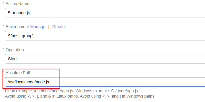

Solution
Enter the correct service path.

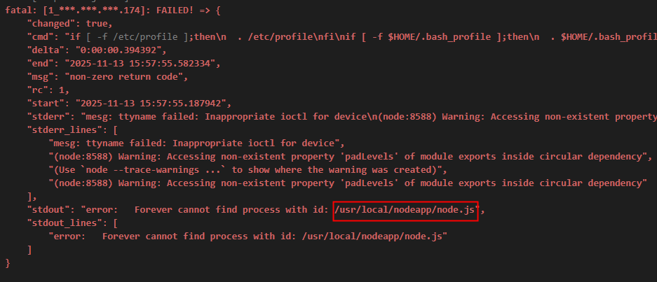

Symptom 2
The stop command of Start/Stop Node.js fails to be executed.
Cause Analysis
The service has been stopped or the service path is incorrect.

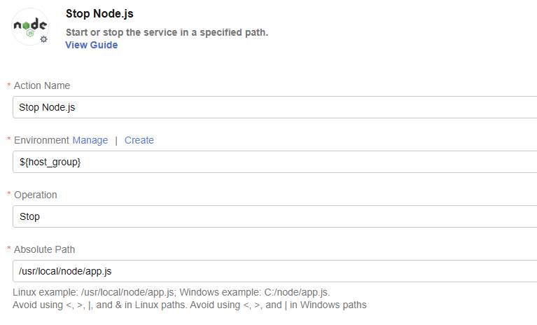

Solution
Cancel the operation of stopping the service, or enter the correct service path.
