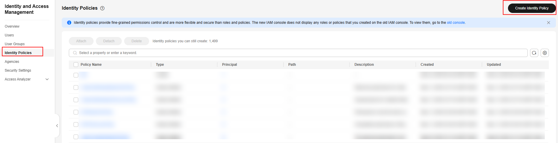

  3. In the navigation pane, choose Identity Policies. On the displayed page, click Create Identity Policy to create an agency policy.
    Figure 2 Creating an agency policy

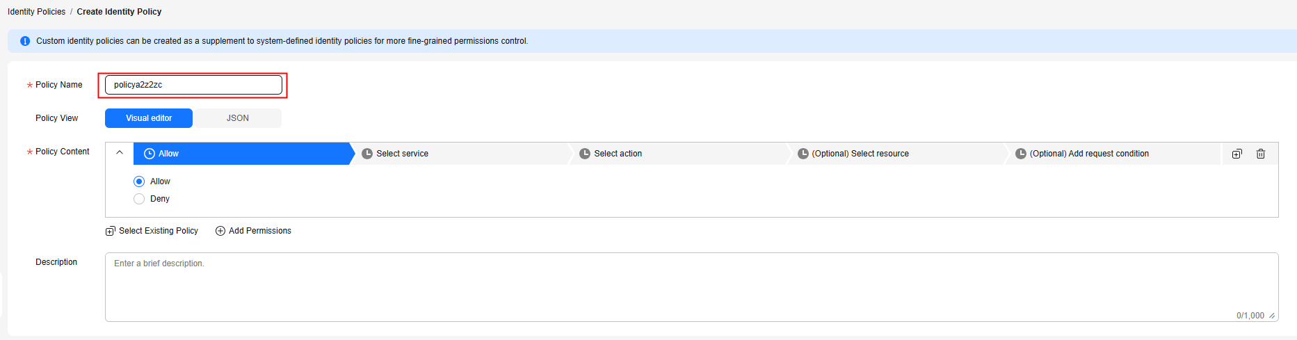

  4. On the displayed page, specify Policy Name.
    Figure 3 Customizing an identity policy name

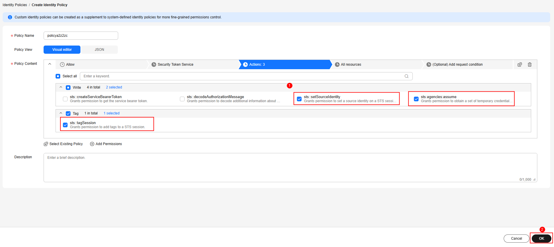

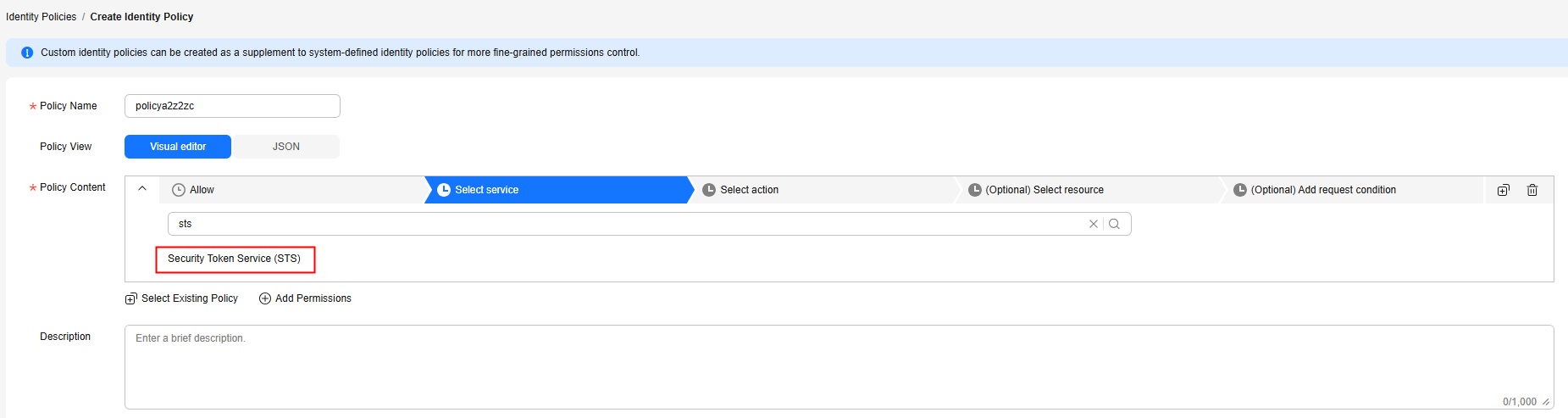

  5. In the Policy Content area, click Select service, search for Security Token Service (STS), and select it. Then, go to Actions.
    Figure 4 Selecting a cloud service
  6. Search for the actions sts:agencies:assume, sts::tagSession, and sts::setSourceIdentity, select them, and click OK. The policy for identity switching is created successfully.
    Figure 5 Creating an identity policy for identity switching

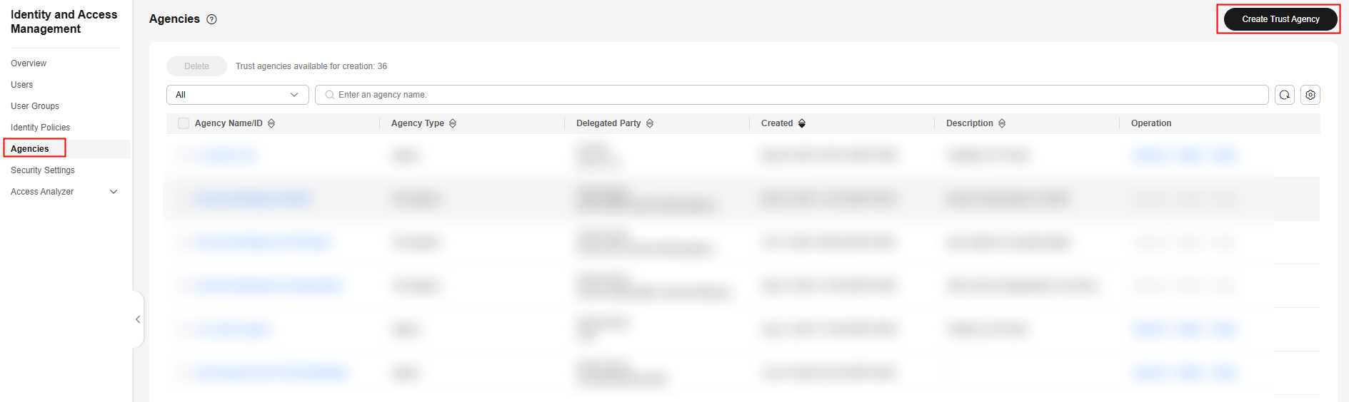

  7. In the navigation pane, choose Agencies.
  8. On the displayed page, click Create Trust Agency.
    Figure 6 Creating a trust agency

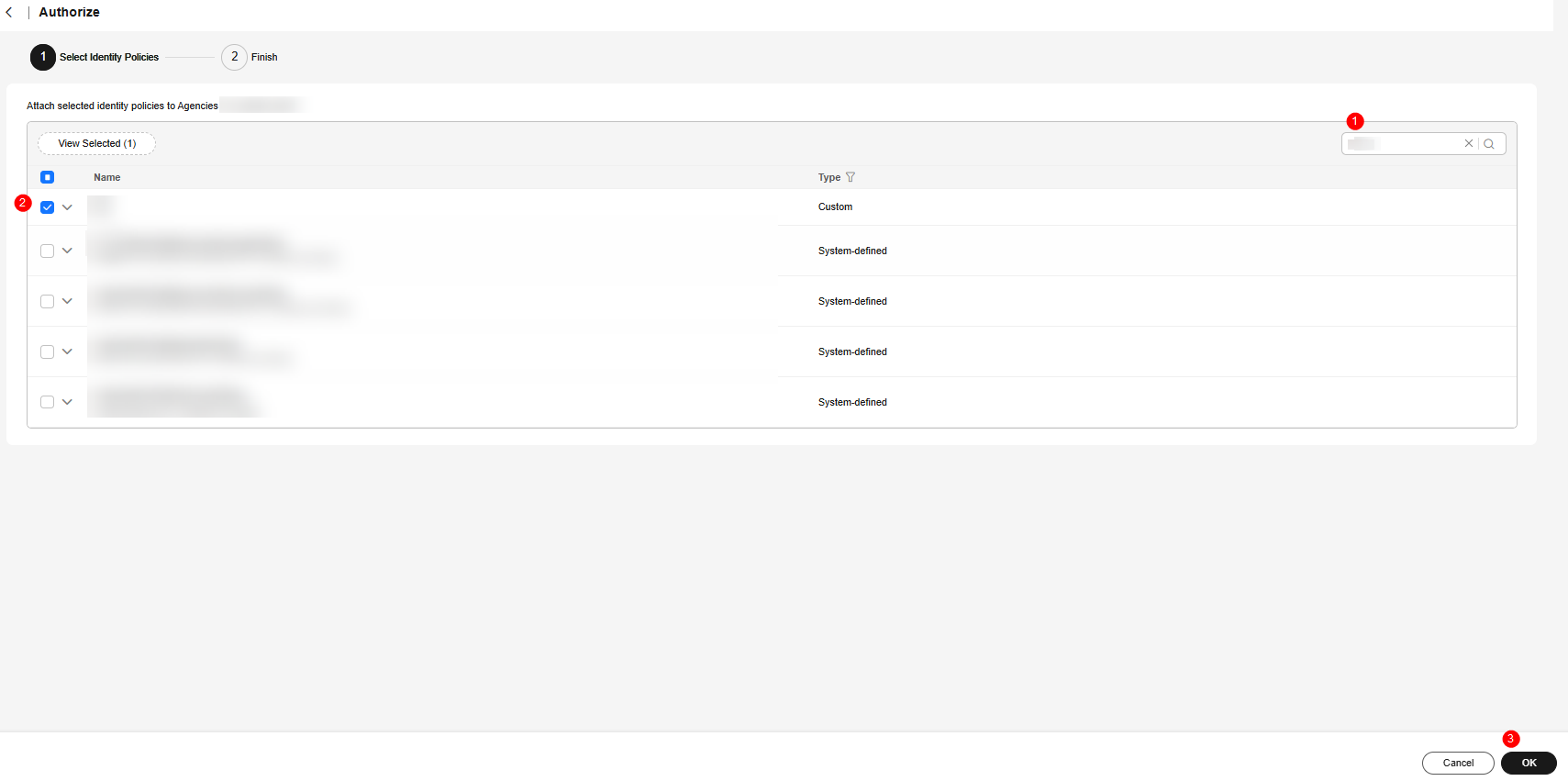

  11. On the displayed page, search for the policy name created in 4 and select it. Click OK.
    Figure 8 Agency authorization

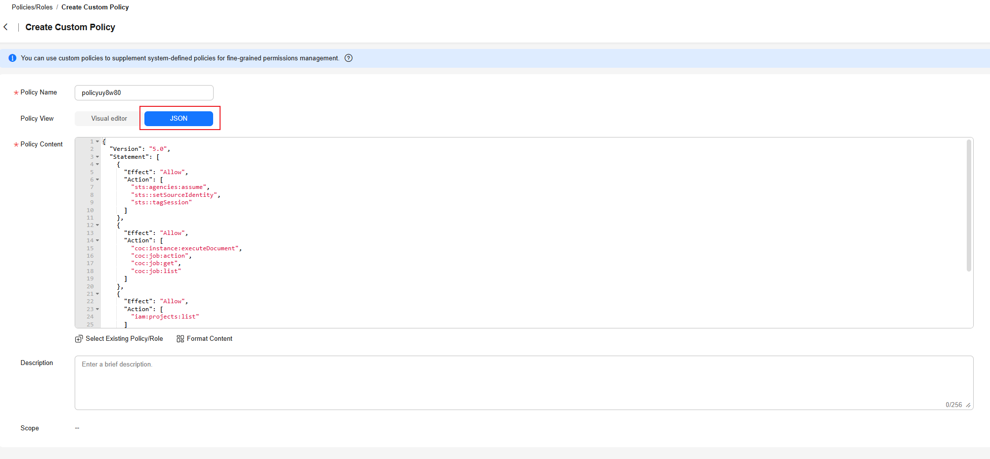

  6. Set Policy View to JSON and enter the following policy content in the text box.
    Figure 11 Customizing policy content
      "Version": "5.0",
      "Statement": [
          "Effect": "Allow",
          "Action": [
            "sts:agencies:assume",
            "sts::setSourceIdentity",
            "sts::tagSession"
          "Effect": "Allow",
          "Action": [
            "coc:instance:executeDocument",
            "coc:job:action",
            "coc:job:get",
            "coc:job:list"
          "Effect": "Allow",
          "Action": [
            "iam:projects:list"
          "Effect": "Allow",
          "Action": [
            "smn:topic:create",
            "smn:topic:subscribe"
  7. Click OK. The identity policy of the execution tenant is created.

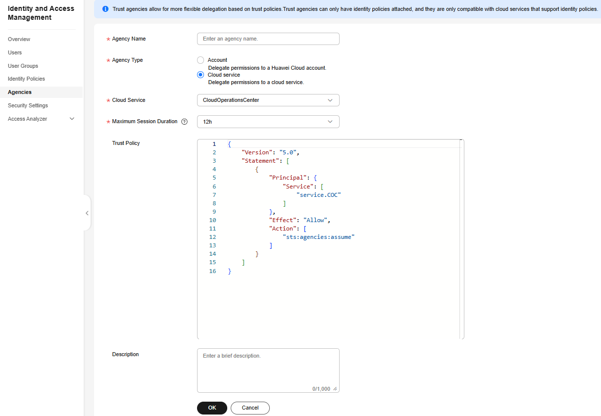

  9. Click Create Trust Agency to create an agency that grants the organization administrator permissions to the execution account.
    • Specify Agency Name.
    • Set Agency Type to Cloud service.
    • Set Cloud Service to CloudOperationsCenter.
    • Set Maximum Session Duration to 12h.
  10. Click OK. The agency is created.

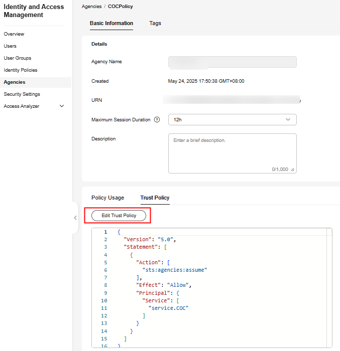

  13. On the Agencies page, locate the agency created in 9 to 12 and click Edit in the Operation column.
    Figure 15 Editing the trust policy 1 for executing the tenant agency

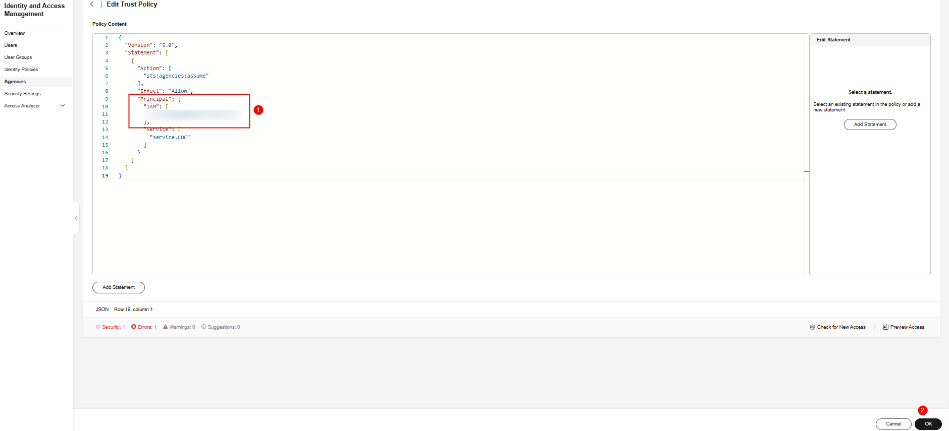

  14. On the Trust Policy tab page, click Edit Trust Policy and add the following JSON data to Principal:
    "IAM": [
              "${Tenant ID of the target organization administrator tenant}"
  15. Click OK. The trust policy is edited. Click OK. The execution account trusts the COC and the organization administrator agency. The account trust policy is created.
