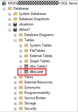

- After the DBLink is created, you can view the databases created in DB instance 1 on the linked server.
- Run the following commands to check whether the data is successfully inserted, as shown in Figure 1:
begin tran set xact_abort on INSERT INTO [LYNTEST].[dbtest1].[dbo].[user1] ([id],[lname],[rname]) VALUES('19','w','x') GO commit tran
