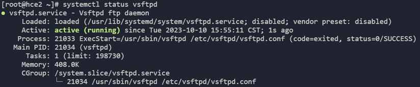

  3. Check the vsftpd status.
    systemctl status vsftpd
    If active (running) is displayed, vsftpd is started, as shown in Figure 1.
    Figure 1 Example: vsftpd status

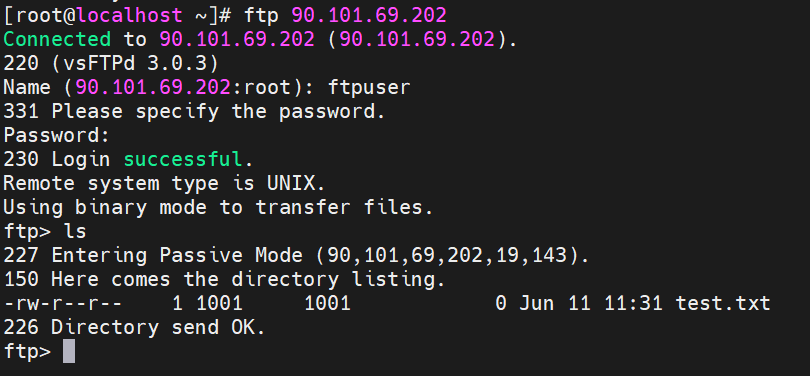

  3. Verify the configuration.
    1. Check the port used by vsftpd.
      netstat -natp | grep vsftpd
      By default, port 21 is used.
    2. Configure security group inbound rules to enable port 21 and all ports between pasv_min_port and pasv_max_port specified in /etc/vsftpd/vsftpd.conf (ports 5000 to 5010 are used as an example).
    3. Run the following command on the client ECS to install the FTP client:
      dnf install -y ftp
    4. Run the following command on the client to access the FTP service:
      ftp <public-IP address-of-the-FTP-server>
    5. Enter the username and password as prompted.
    6. After the login is successful, run ls. If the test.txt file is displayed, the configuration is successful.
      Figure 2 Verification example
