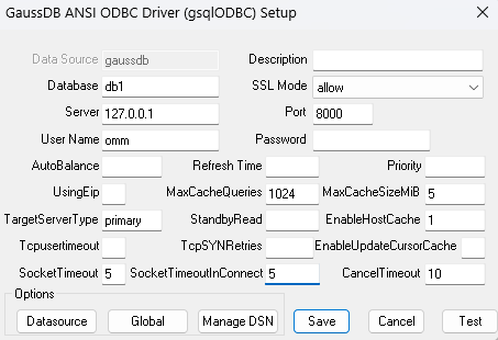

Figure 1 shows the recommended configurations for the data source manager in Windows environments.
Adjust the preceding data source configurations, including but not limited to the database server IP address, port number, and other connection parameters, to match the actual services.
