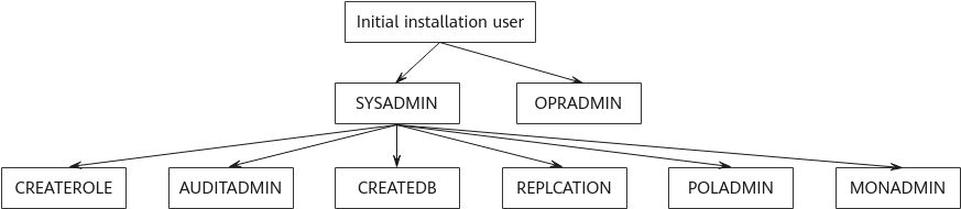

Figure 1 shows the permission architecture. In the default permission mechanism, the SYSADMIN has most permissions.
- Initial installation user: an account automatically generated during cluster installation. This account has the highest permissions in the system and can perform all operations.
- SYSADMIN: system administrator permissions, which are only inferior to those of the initial installation user. By default, the system administrator has the same permissions as the object owner, excluding the MONADMIN and OPRADMIN permissions. However, SYSADMIN can grant the MONADMIN permissions to itself.
- MONADMIN: monitor administrator permissions, including the permissions to access and grant views and functions in the monitor schema DBE_PERF.
- OPRADMIN: O&M administrator permissions, including the permission to use Roach to perform backup and restoration.
- CREATEROLE: security administrator permissions, including the permissions to create, modify, and delete users and roles.
- AUDITADMIN: audit administrator permissions, including the permissions to view and maintain database audit logs.
- CREATEDB: permission to create databases.
- POLADMIN: security policy administrator permissions, including the permissions to create resource labels, dynamic data masking policies, and unified audit policies.

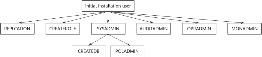

- Separation of duties
Figure 2 Separation of duties
- SYSADMIN: system administrator permission. The user with this attribute no longer has the permissions to create, modify, delete users or roles, or view or maintain database audit logs.
- A user or role can only have the system permissions of either SYSADMIN, CREATEROLE, o AUDITADMIN.
