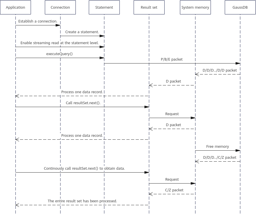

- When a streaming query is executed, the server keeps sending data to the client's socket buffer until the buffer is full. Upon the arrival of the first data record in the buffer, the first D packet is returned. JDBC then begins loading and processing data from the buffer row by row.
- The result set is designed to store only one row of data. The next data record is read from the buffer and stored into the result set only when the "next" method is called. This process repeats until all records have been read.
