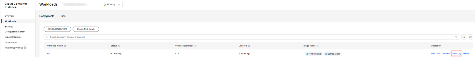

    In the workload list, if the workload status changes to Running, the workload is created. You can click the workload name to view the details and refresh the page to view the real-time workload status.

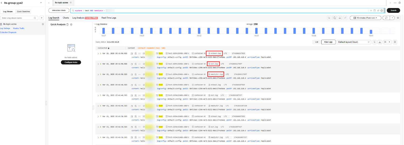

  8. Wait until the workload enters the running status and click View Log in the Operation column to view the logs reported by the pod.

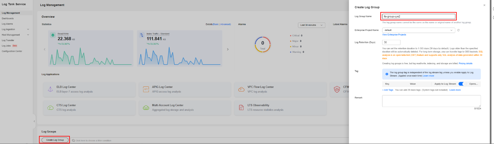

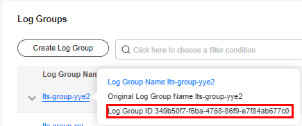

  1. Log in to the LTS console and create a log group.

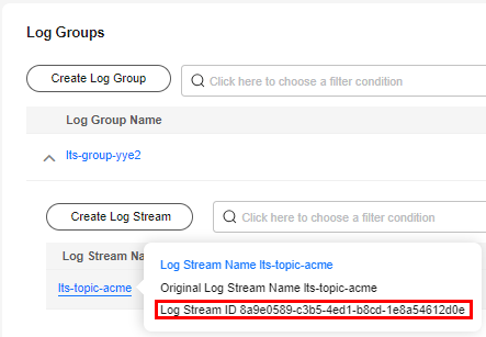

  2. Create a log stream in the created log group.

            logconfigs.logging.openvessel.io: "{\"default-config\":{\"container_files\":{\"container-0\":\"stdout.log;\/root\/out.log;\/data\/emptydir-volume\/*.log\"},\"lts-log-info\":{\"349b50f7-f6ba-4768-86f9-e7f84ab677c0\":\"8a9e0589-c3b5-4ed1-b8cd-1e8a54612d0e\"}}}"  # Log reporting configuration

                "f938a11a-678e-4631-80a0-3667be1280f7": "a248c18b-61ed-4de2-8f7f-c042b78bb0fd" // Log group ID and log stream ID in the format of {log-group-ID}:{log-stream-ID}

  6. Wait until the workload enters the running status and click View Log in the Operation column to view the logs reported by the pod.
