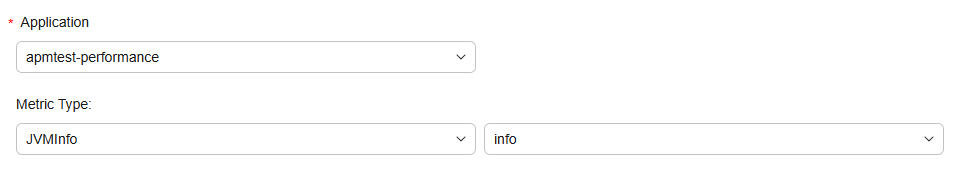

- Select an application and metric type. Select apmtest-performance (created in Connecting an Agent) for Application and select JVMInfo and info for Metric Type. Figure 1 Metric source

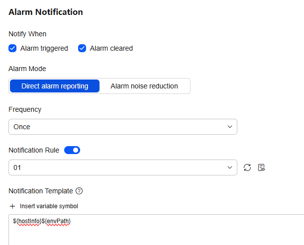

- Set an alarm notification policy. For details, see Table 5. Figure 2 Setting an alarm notification policy
Table 5 Alarm notification policy parameters Parameter
Description
Example Value
Notify When
Set the scenario for sending alarm notifications.
- Alarm triggered: If the alarm trigger condition is met, the system sends an alarm notification to the specified personnel by email or SMS.
- Alarm cleared: If the alarm clearance condition is met, the system sends an alarm notification to the specified personnel by email or SMS.
Alarm triggered
Alarm cleared
Alarm Mode
- Direct alarm reporting: An alarm is directly sent when the alarm condition is met. If you select this mode, set an interval for notification and specify whether to enable a notification rule.
- Frequency: interval for sending alarm notifications. Select a desired value from the drop-down list.
- Notification Rule: After the rule is enabled, the system sends notifications based on the associated SMN topic and message template. If there is no alarm notification rule you want to select, click Add Rule in the drop-down list to create one. For details about how to set alarm notification rules, see Creating an AOM Alarm Notification Rule.
Alarm Mode: Select Direct alarm reporting.
Frequency: Select Once.
Notification Rule: Enter 01.
Notification Template
Template for sending alarm notifications. You can use variables (that is, dimensions) in a notification template. The format is "${Dimension}". You can click Insert Variable Symbol to add ${}.
- Inserting a variable: Hover the cursor over a variable under Variables Preview and click Insert to insert the variable to the notification template.
- Copying a variable: Hover the cursor over a variable under Variables Preview and click Copy to copy the variable.
- Viewing preset variables: The system provides preset variables.
${hostInfo}${envPath}
