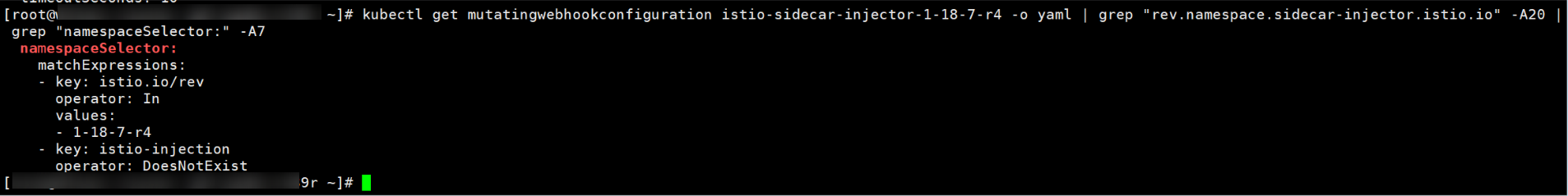

    Check method: Run the following command to view the webhook's namespaceSelector:
    kubectl get mutatingwebhookconfiguration istio-sidecar-injector-1-18-7-r4 -o yaml | grep "rev.namespace.sidecar-injector.istio.io" -A20 | grep "namespaceSelector:" -A7
    Replace 1-18-7-r4 in the preceding command with the service mesh version in the current format (combined with hyphens). The service mesh version is specified by Version on the Basic Information tab (Mesh Configuration > Basic Information).
    For example, the command output in the preceding figure indicates that the istio.io/rev=1-18-7-r4 label is required and the istio-injection label is not allowed.
