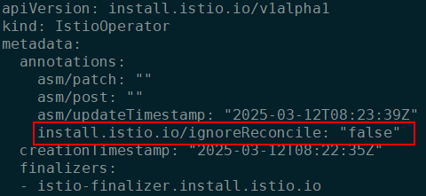

Perform the following operations only in Istio 1.18.7-r4 or later.
After running the kubectl edit iop command to edit the parameter to be modified, change the value of install.istio.io/ignoreReconcile to false, save the modification, and exit.
Run the kubectl get iop -n istio-system command to check the IOP status. Wait until the value of STATUS changes to HEALTHY.
Change the value of install.istio.io/ignoreReconcile to true.
