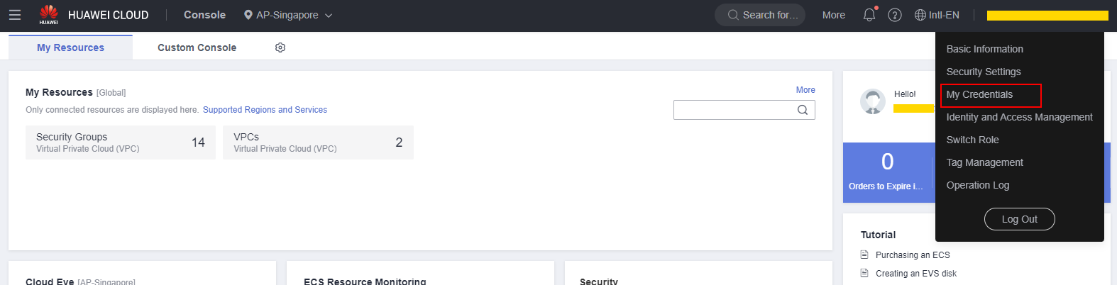

Obtaining a Project ID from the Console
- Log in to the console.
- Hover over the username in the upper right corner and select My Credentials from the drop-down list.
Figure 1 Console
