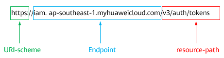

Request URI
A request URI is in the following format:
{URI-scheme}://{Endpoint}/{resource-path}?{query-string}
Although a request URI is included in the request header, most programming languages or frameworks require the request URI to be transmitted separately.
| Parameter | Description |
| URI-scheme | Protocol used to transmit requests. All APIs use HTTPS. |
| Endpoint | Domain name or IP address of the server bearing the REST service. The endpoint varies between services in different regions. It can be obtained from Regions and Endpoints. For example, the endpoint of IAM in the CN-Hong Kong region is iam.ap-southeast-1.myhuaweicloud.com. |
| resource-path | Access path of an API for performing a specified operation. Obtain the path from the URI of an API. For example, resource-path of the API used to obtain a user token is /v3/auth/tokens. |
| query-string | An optional query parameter. Ensure that a question mark (?) is included before each query parameter that is in the format of Parameter name=Parameter value. For example, ? limit=10 indicates that a maximum of 10 data records will be displayed. |
For example, to obtain an IAM token in the CN-Hong Kong region, obtain the endpoint of IAM (iam.ap-southeast-1.myhuaweicloud.com) for this region and resource-path (/v3/auth/tokens) in the URI of the API used to obtain a user token. Then, construct the URI as follows:
1 | https://iam.ap-southeast-1.myhuaweicloud.com/v3/auth/tokens |
To simplify the URI display in this document, each API is provided only with a resource-path and a request method. URI-scheme of all APIs is HTTPS, and the endpoints of all APIs in the same region are identical.
