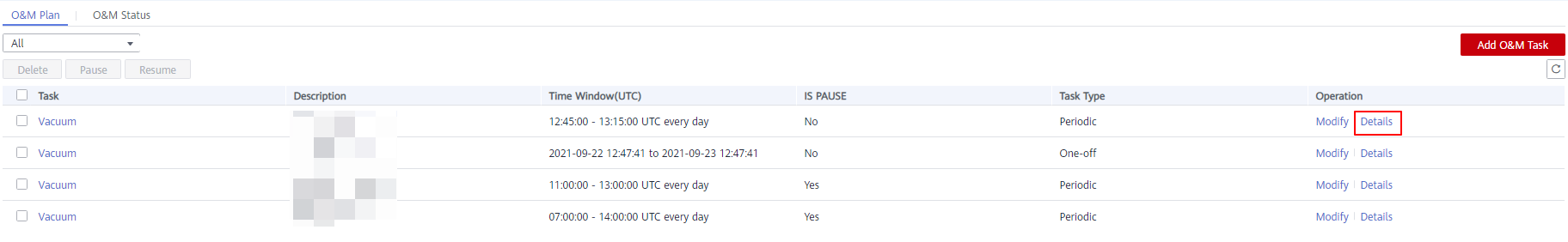

Viewing O&M Task Details
  1. Log in to the DWS console.
  2. Click the name of the target cluster.
  3. In the navigation pane, choose Intelligent O&M.
  4. In the O&M Plan area, click Details in the Operation column of the target task.
  5. The O&M Task Details panel is displayed for you to check the information.
