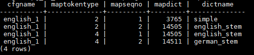

Query information about the text search configuration.
SELECT b.cfgname,a.maptokentype,a.mapseqno,a.mapdict,c.dictname FROM pg_ts_config_map a,pg_ts_config b, pg_ts_dict c WHERE a.mapcfg=b.oid AND a.mapdict=c.oid AND b.cfgname='english_1' ORDER BY 1,2,3,4,5;
  cfgname  | maptokentype | mapseqno | mapdict |   dictname
 english_1 |            2 |        1 |    3765 | simple
 english_1 |            2 |        2 |   12960 | english_stem
 english_1 |            4 |        1 |   12960 | english_stem
 english_1 |            4 |        2 |   12966 | german_stem
(4 rows)
