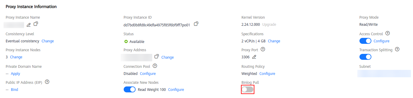

- Click a proxy instance name to go to the Basic Information page.
- In the Proxy Instance Information area, click
on the right of Binlog Pull. Figure 1 Enabling binlog pull
- In the displayed dialog box, click OK.

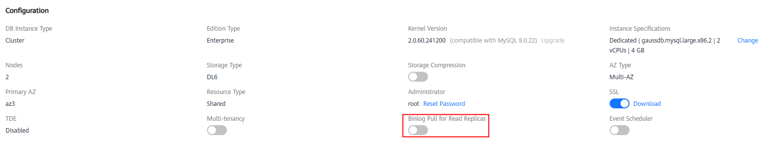

in the upper left corner and select a region and project. - On the Instances page, click the instance name to go to the Basic Information page.

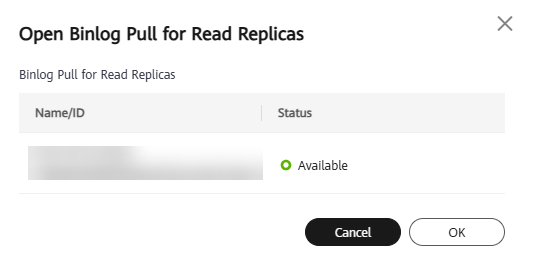

- In the Configuration area, click
under Binlog Pull for Read Replicas.
- In the displayed dialog box, click OK. The DB instance status changes from Binlog pull is being configured for the read replicas to Available. This process takes several seconds. Figure 2 Enabling binlog pull for read replicas
on the right of Binlog Pull. Figure 3 Enabling binlog pull
- In the displayed dialog box, click OK. The proxy instance status changes from Changing binlog pull of the proxy instance to Available. This process takes several seconds.

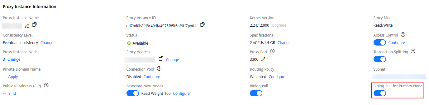

- Check whether Binlog Pull for Primary Node is enabled. If it is, click

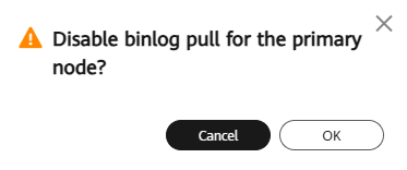

to disable it. Then, binlogs will only be pulled from read replicas. Figure 4 Checking whether Binlog Pull for Primary Node is enabled
Figure 5 Disabling binlog pull for the primary node
