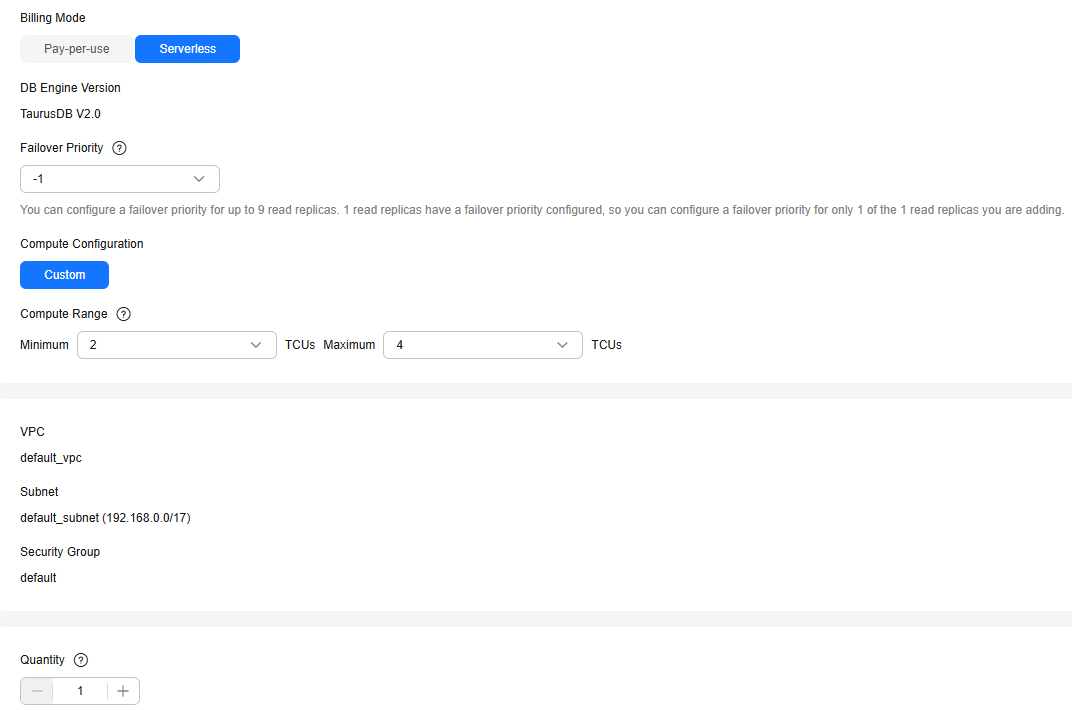

  3. On the Instances page, locate the instance you want to add read replicas to and choose More > Create Read Replica in the Operation column.
  4. On the displayed page, select the serverless billing mode and set other parameters.
    Figure 1 Creating serverless read replicas
    Table 1 Parameter description
    Parameter
    Description
    Failover Priority
    The failover priority of a serverless read replica is fixed to -1. During a failover, the serverless read replica will not be promoted to primary. The failover priority for serverless read replicas cannot be changed.
    Compute Range
    • Minimum TCUs: Set the minimum compute. 1 TCU is approximately equal to 1 vCPU and 2 GB of memory. The initial specifications of a new serverless read replica are the minimum compute.
    • Maximum TCUs: Set the maximum compute.
    Quantity
    Up to seven serverless read replicas can be created for each instance.

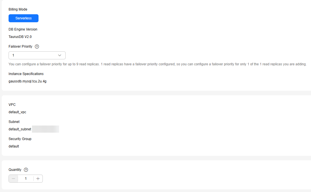

  1. Log in to the TaurusDB console.
  2. Click in the upper left corner and select a region.
  4. On the displayed page, set Failover Priority and Quantity.
    Figure 2 Creating serverless read replicas
    Table 2 Parameter description
    Parameter
    Description
    Failover Priority
    Failover priority ranges from 1 for the first priority to 16 for the last priority. This priority determines the order in which read replicas are promoted when recovering from a primary node failure. Read replicas with the same priority have a same probability of being promoted to the new primary node.
    Quantity
  5. Click Next.
  6. Check the read replica settings.
    • If you need to modify the settings, click Previous.
    • If you do not need to modify the settings, click Submit.
  7. View or manage the created read replicas in the Node List area on the Basic Information page.
