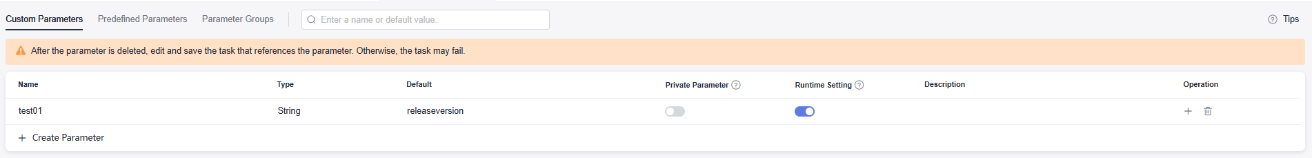

Configuring Custom Parameters

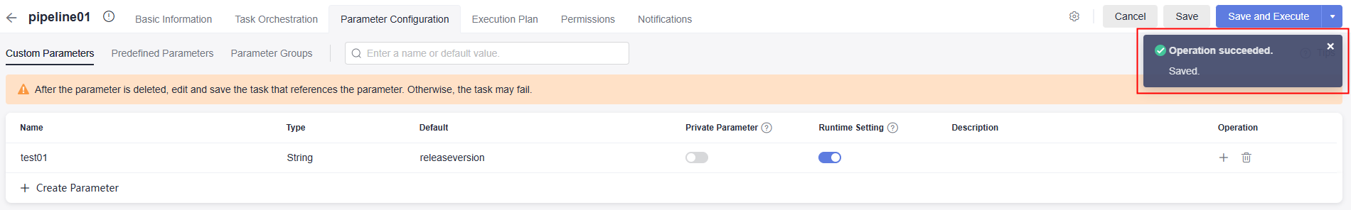

You can create and configure pipeline parameters. The parameter reference format is ${Parameter name}. Enter $ in the text box and the custom parameter list will be displayed.
  1. Access the CodeArts Pipeline homepage.
  2. On the pipeline list page, search for the target pipeline, click in the Operation column, and click Edit.
  3. Switch to the Parameter Configuration tab page.
  4. On the displayed page, click Create Now to configure parameters. If there are custom parameters, click Create Parameter to add a new one.
    Figure 1 Creating a custom parameter
    Table 2 Custom parameters
    Parameter
    Description
    Example Value
    Name
    The specified name cannot be the same as that of a predefined parameter. Enter a maximum of 128 characters, including letters, digits, and underscores (_).
    Enter test01.
    Type
    Parameter types, including String (default), Auto Increment, and Enumeration.
    Select String.
    Default
    Default value of the parameter.
    • String: The value can contain no more than 8,192 characters. It can be left blank.
    • Auto-Increment: The value can contain no more than 8,192 characters. The value cannot be empty. If an auto-increment parameter is referenced in a pipeline, its value (which ends with a digit) is incremented by 1 each time the pipeline runs.
    • Enumeration: Enter a maximum of 8,192 characters, including only letters, digits, hyphens (-), underscores (_), commas (,), periods (.), and slashes (/).
      After you select Enumeration, the Enumeration dialog box is displayed for you to set optional values. The value cannot be empty. After that, click the Default drop-down list box, select or search for a value.
    Enter releaseversion.
    Private Parameter
    Parameters are encrypted for storage and decrypted at runtime. Private parameters are not displayed in run logs and will not be cloned synchronously during pipeline cloning. Only parameters of string can be set to Private Parameter.
    Runtime Setting
    If Runtime Setting is enabled, you can change the value of the parameter during execution configuration.
    Click to enable Runtime Setting.
    Description
    Description of the custom parameter. Enter a maximum of 512 characters.
    Operation
    Click in the Operation column to add a parameter.
    Click in the Operation column to delete a parameter.
  5. After the configuration, click Save. A message is displayed, indicating that the pipeline is saved successfully.

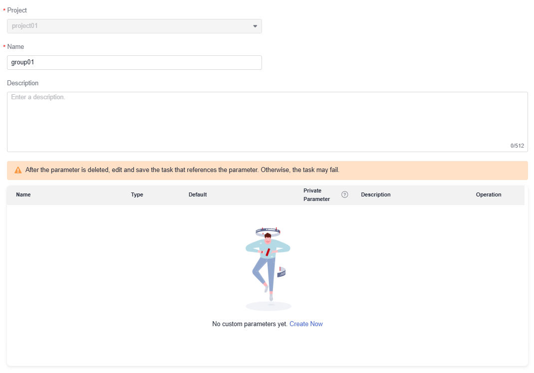

  2. Click the Parameter Groups tab and then click Create Group.
  3. On the displayed page, set parameters by referring to Table 3.
    Figure 2 Creating a parameter group

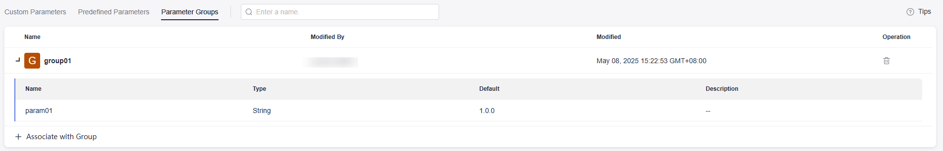

  5. Locate the pipeline to be associated with the parameter group, click in the Operation column, and select Edit. Click the Parameter Configuration tab and click Parameter Groups.
  6. Click Associate Now, select the desired parameter group, and click Confirm to associate the pipeline with the parameter group.
    • Expand the group to check parameter details.
    • Click in the Operation column to diassociate from the parameter group.
    Figure 3 Associating with a parameter group

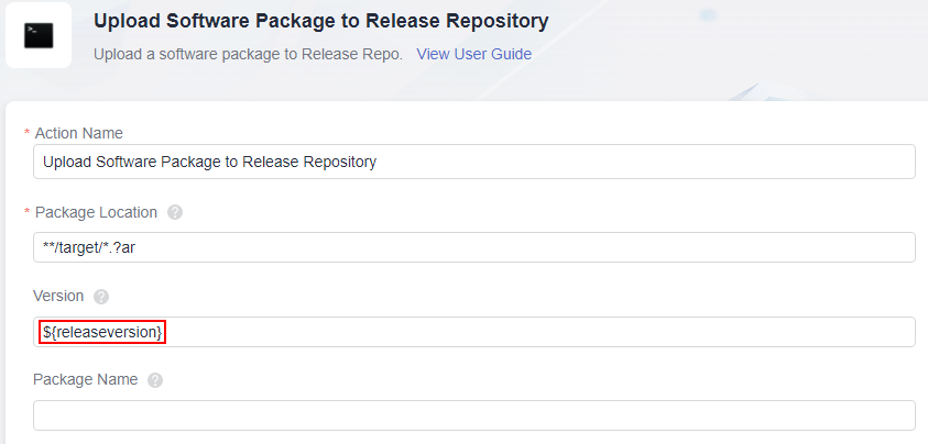

  3. Click the Build Actions tab. On the displayed page, click Add Action, move the cursor to the Upload to Release Repo card, click Add, and set Version to a reference parameter. After you enter $ in the text box, a parameter list is displayed. Select the releaseversion parameter created in the previous step. $ will not trigger the display of parameter groups.
    Figure 5 Referencing a build task parameter

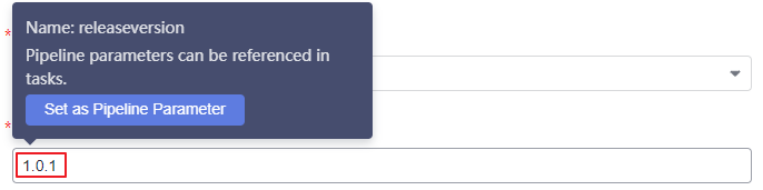

  5. Create a pipeline using the blank template, add the Build extension and select the created build task. The parameter releaseversion is displayed.
    Figure 6 Configuring a build task parameter

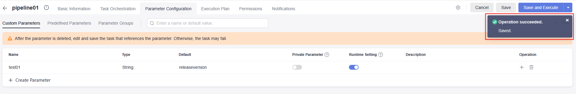

  6. Move the cursor to the releaseversion parameter and click Set as Pipeline Parameter. Alternatively, click OK, switch to the Parameter Configuration tab page, create the pipeline parameter releaseversion, set Type to Auto-increment or String, set a default value, and enable Runtime Setting.
    Figure 7 Creating a pipeline parameter
