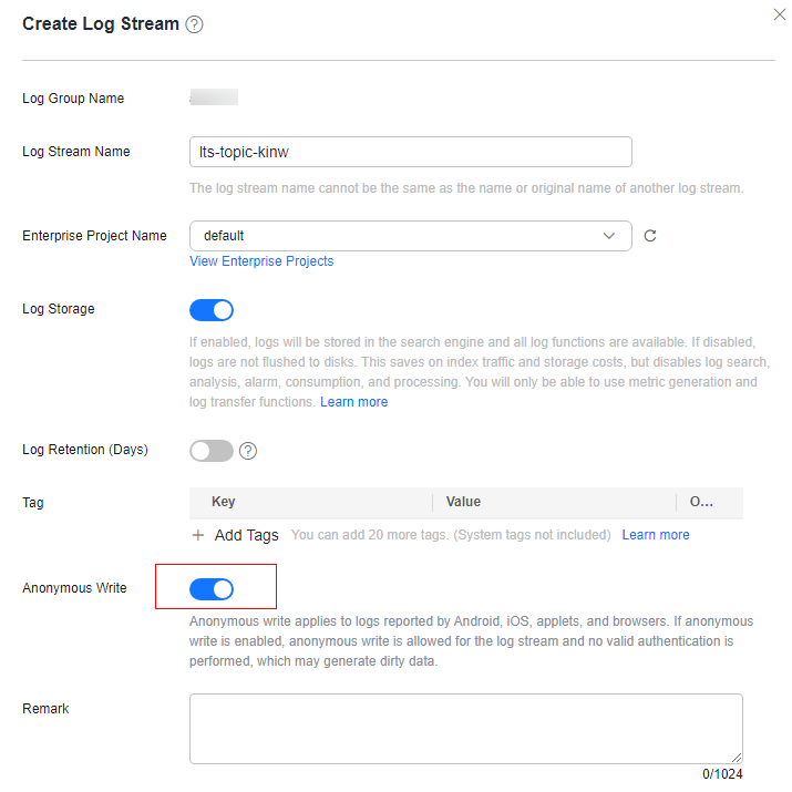

  1. Log in to the LTS console.
  2. Click on the left of the target log group.
  3. Click Create Log Stream. On the page displayed, set the parameters by referring to Table 1 and enable Anonymous Write. This function is applicable to scenarios where devices report logs via SDKs. By enabling it, you grant the log stream permission for anonymous writing, which means no valid authentication will be performed. This may lead to the generation of dirty data.
    Figure 1 Creating a log stream

    Anonymous Write
    Anonymous write is disabled by default. Only logs reported by Android, iOS, applets, and browsers can be written anonymously.
    This function is available only to whitelisted users. To use it, submit a service ticket.
    If anonymous write is enabled for a log stream, no valid authentication is required, which may lead to the generation of dirty data. For details about how to use SDKs, see Using SDKs to Ingest Logs to LTS.
    NOTE:
    The function of using anonymous write to collect logs is available only to whitelisted users in regions CN North-Beijing4, CN East-Shanghai1, and CN South-Guangzhou. To use it, submit a service ticket.

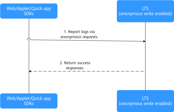

LTS supports anonymous log writing via client SDKs and HTTP GET requests.
  • Client SDKs: uploads custom logs, such as form submission, page submission, and exception reports, to LTS via the web SDK, applet SDK, or quick app SDK. For details about how SDKs report logs, see Using SDKs to Ingest Logs to LTS.
    Figure 2 Client SDKs

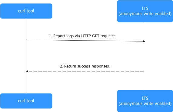

  • HTTP GET requests: sends GET requests in the frontend code of a website to upload logs to LTS. This method is suitable for simple log collection. For details, see Uploading Logs Using HTTP GET Requests.
    Figure 3 HTTP GET requests
