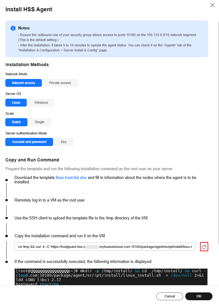

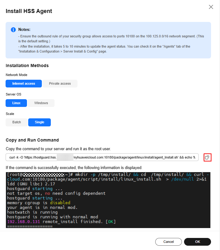

- Click
to copy the installation command.
Figure 1 Copying the installation command
- Log in to the server as user root, and paste and run the installation command.
If the command output shown in Figure 2 is displayed, the agent has been installed.
Figure 2 Agent installed

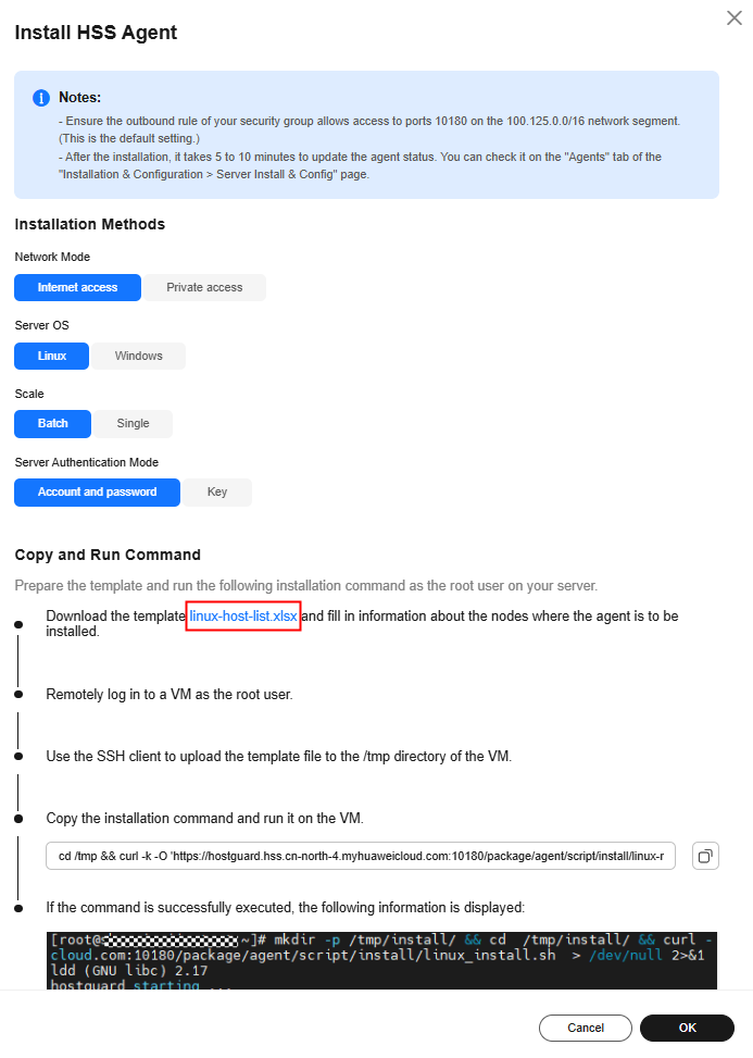

- On the console, click linux-host-list.csv in the Install HSS Agent dialog box to download the template.
Figure 3 Downloading linux-host-list.csv
- Fill in the server information based on the requirements in the linux-host-list.csv template and save it.
- Use the root account to remotely log in to any target server.
- Use the SSH client to upload the template file linux-host-list.csv to the /tmp directory on the server.
- Return to the HSS console and click
Figure 4 Copying the installation command

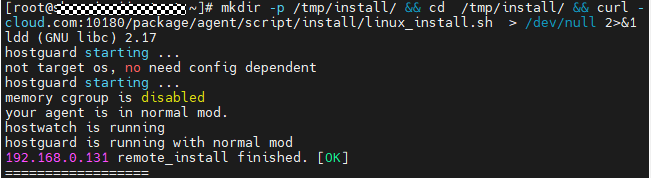

- Paste and run the installation command on the server to install the agent.
If the command output shown in Figure 5 is displayed, the agent has been installed.
Figure 5 Agent installed

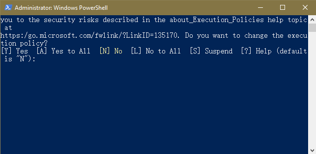

- Right-click installAgent.ps1 and choose Run with PowerShell.
- (Optional) In the dialog box that is displayed, enter Y to run the script to install the agent.
If no dialog box is displayed, skip this step.
Figure 7 Changing the execution policy

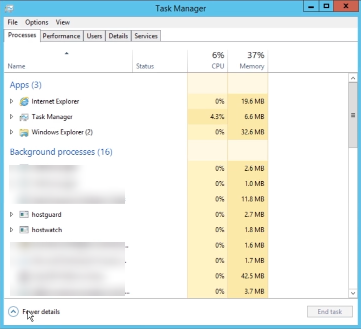

- After the execution, open the Task Manager and check whether hostguard.exe and hostwatch.exe exist. If they do, the agent has been installed.
Figure 8 Agent installed

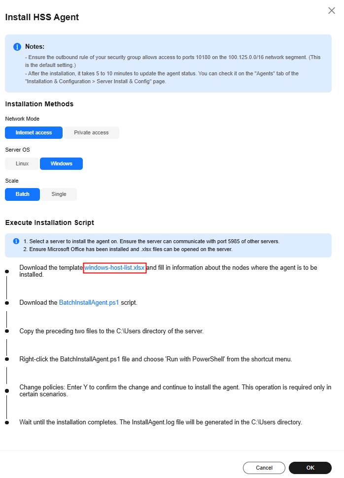

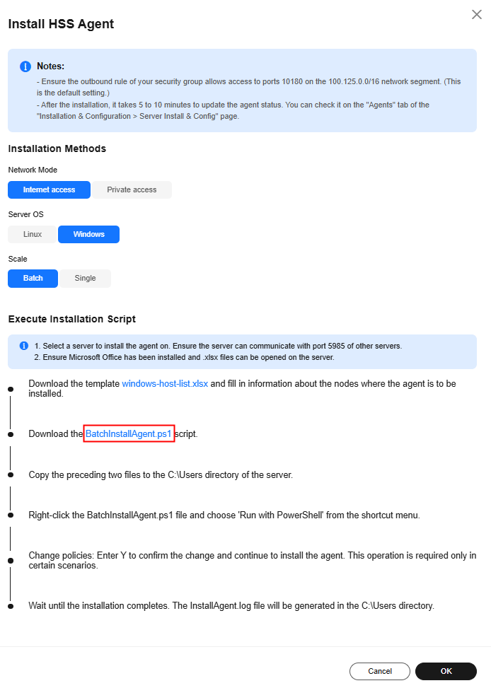

- On the console, click windows-host-list.xlsx in the Install HSS Agent dialog box to download the template to the local PC.
Figure 9 Downloading windows-host-list.xlsx
- Enter server information based on the requirements in the windows-host-list.xlsx template and save it.
- Return to the HSS console and click BatchInstallAgent.ps1 to download the installation script.
Figure 10 Downloading BatchInstallAgent.ps1

- Right-click BatchInstallAgent.ps1 and choose Run with PowerShell.
Figure 11 Changing the execution policy
