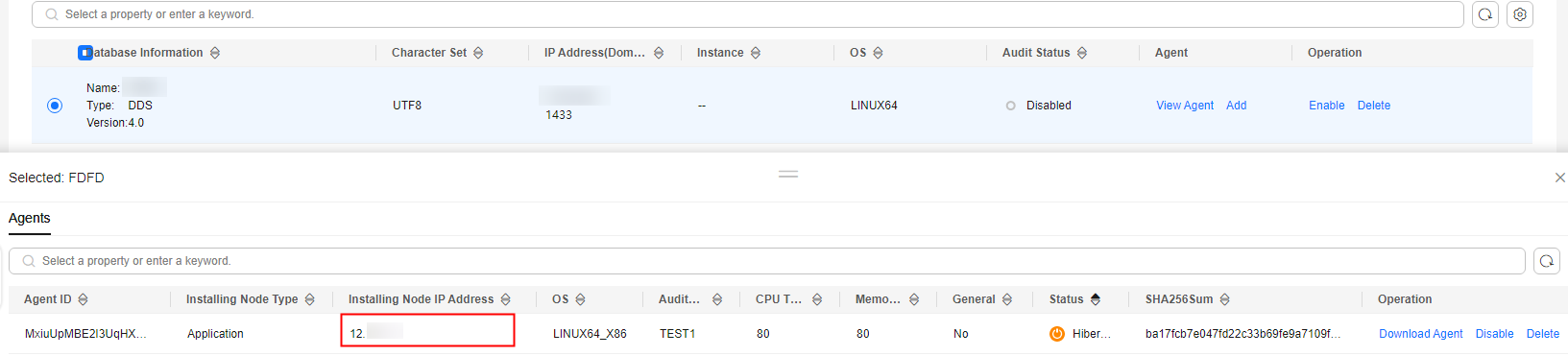

- Record the IP address of the agent node.
Locate the row that contains the target database, and click View Agent in the Agent column. In the Agents area, record the Installing Node IP Address.
Figure 1 Installing Node IP Address - Click Add Security Group Rule.

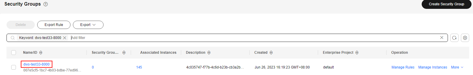

- In the displayed dialog box, record the security group name (for example, default) of the database audit instance, as shown in Figure 2.
- Click Go to VPC.
- In the search box above the list, select an attribute or enter a keyword to search for a security group. Click the security group name.
Figure 3 Security group

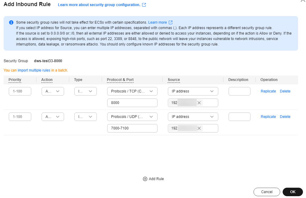

- Add an inbound rule for the installing node.
- On the Inbound Rules tab, click Add Rule.
Figure 4 Adding rules
- In the Add Inbound Rule dialog box, add TCP (port number 8000) and UDP protocols (port number from 7000 to 7100).
The source can be an IP address, an IP address segment, or a security group. Examples:
- IP address: 192.168.10.10/32
- IP address segment: 192.168.52.0/24
- All IP addresses: 0.0.0.0/0
- Security group: sg-abc
Figure 5 Add Inbound Rule dialog box - Click OK.
