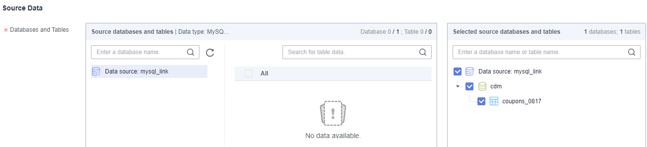

    Select the GaussDB databases and tables to be migrated.
    Figure 5 Selecting databases and tables
    Both databases and tables can be customized. You can select one database and one table, or multiple databases and tables.

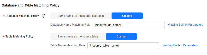

          Figure 6 Database and table matching policy in the entire database migration scenario
          When you customize a matching policy, you can use built-in variables #{source_db_name} and #{source_table_name} to identify the source database name and table name. The table matching policy must contain #{source_table_name}.

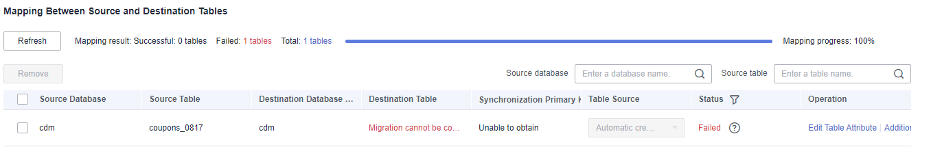

  8. Refresh and check the mapping between the source and destination tables. In addition, you can modify table attributes, add additional fields, and use the automatic table creation capability to create tables in the destination Hudi database.
    Figure 7 Mapping between source and destination tables
