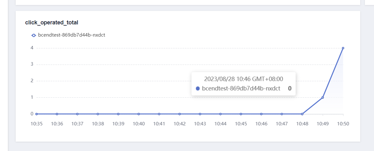

  9. After the configuration and deployment are complete, you can view monitoring metrics on the Component Monitoring page.
    Figure 2 Viewing custom metrics
