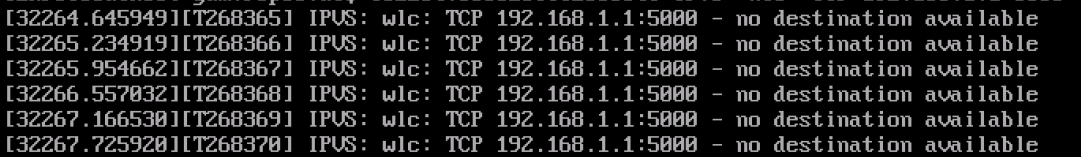

If an IPVS is configured but no real server is set up, when a network request is sent to the virtual server address, an error log similar to the following is displayed in the CLI after you log in to the ECS using VNC.

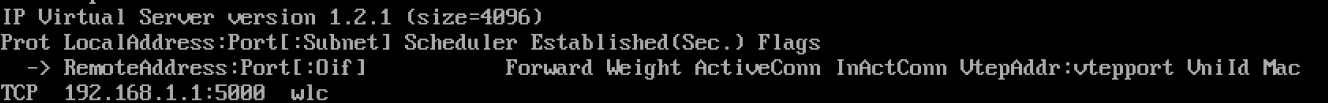

- Run the ipvsadm -Ln command to query the configuration of the current virtual server. Find the entry corresponding to the virtual server for which an error is reported.
Figure 2 No real server configured
If no real server is configured, the configuration is incomplete, and an error is generated. Check your service process.

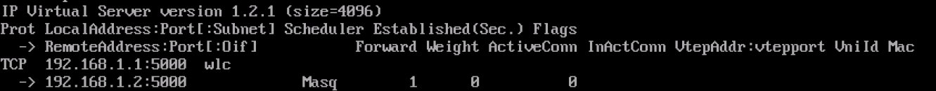

Figure 3 Real server configured
As shown in the figure, a real server is configured.
