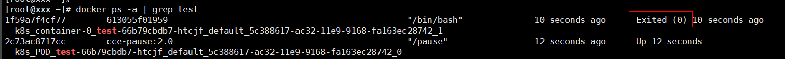

No Process in the Pod (Exit Code: 0)
  1. Log in to the node where the abnormal workload is located.
  2. View the pod status.
    If the node uses Docker, run the following command:
    docker ps -a | grep $podName
    If the node uses containerd, run the following command:
    crictl ps -a | grep $podName
    Below shows an example.
    If there is no process in the pod, the status code Exited (0) is displayed.

    Figure 2 Incorrect startup command of the container
    As shown in the figure above, the container fails to be started due to an incorrect startup command. For other errors, rectify the bugs based on the logs.
Solution
Create a new workload and configure a correct startup command.
