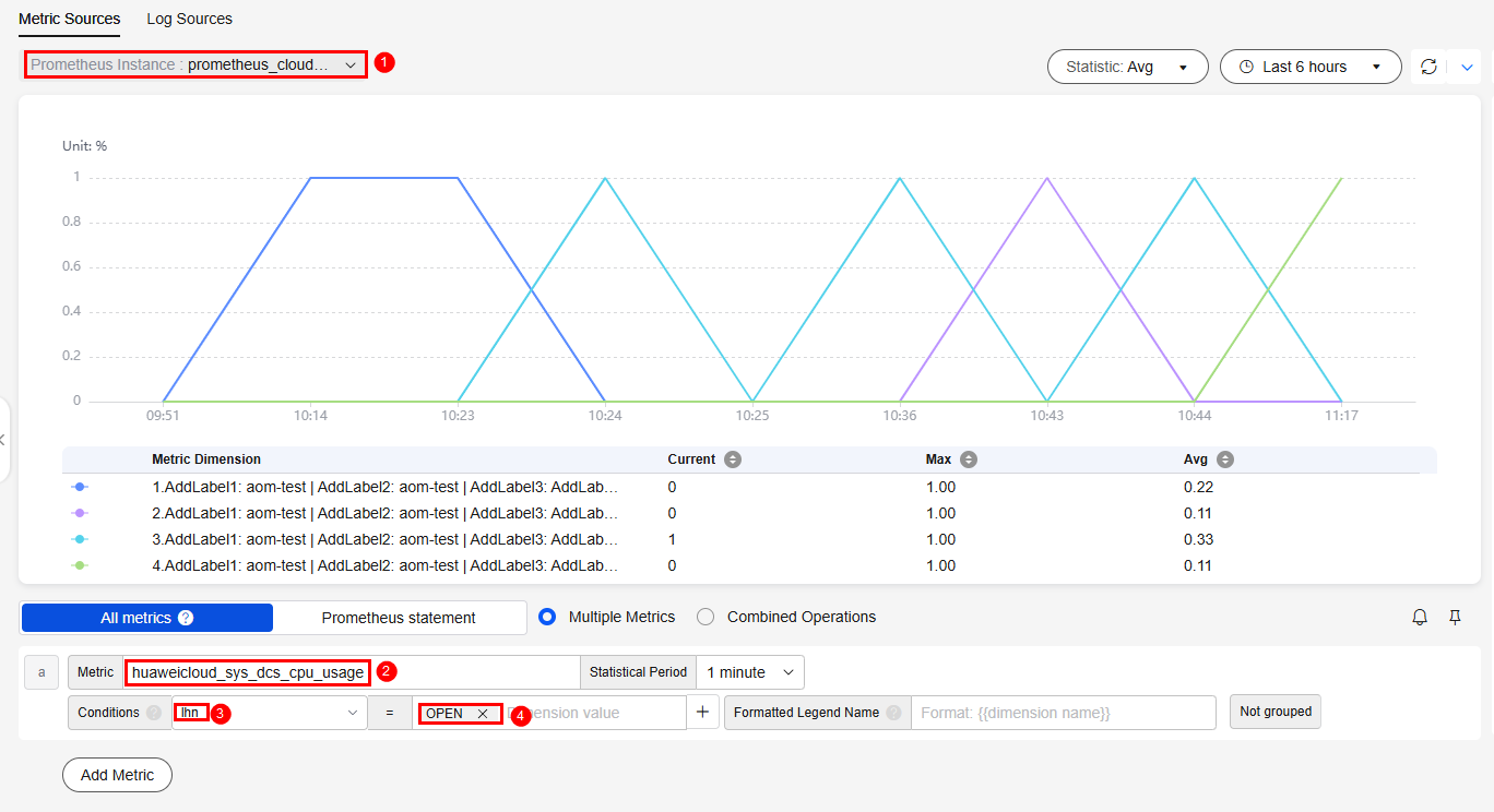

- Check whether the cloud service metric and tag have been connected.
- In the navigation pane, choose Metric Browsing.
- On the Metric Sources tab page, select the Prometheus instance created in 3.
- Select the metric to be monitored from the Metric drop-down list and select the tag added in step 1 from the Conditions drop-down list to check whether the cloud service metric and tag have been connected. As shown in Figure 1, the CPU Usage metric and Ihn tag of the DCS service have been connected.

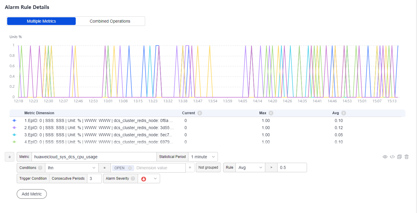

- Set the detailed information about the alarm rule.
- By default, the rule type, configuration mode, and Prometheus instance in the alarm rule settings are the same as those on the Metric Browsing page.
- Set alarm rule details. The metric and its conditions are consistent with those configured on the Metric Browsing page. Set parameters such as the statistical period and detection rule as required. As shown in Figure 2, in a 1-minute statistical period, if the average value of the monitored object is greater than 0.5 for three consecutive periods, a critical alarm (
) will be generated. - Under Advanced Settings, set information such as Check Interval and Alarm Clearance. In this example, retain the default settings.

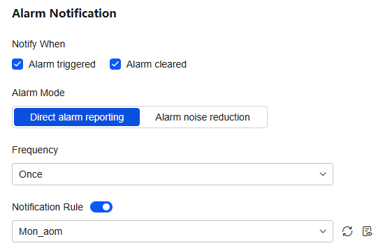

- Set an alarm notification policy. There are two alarm notification modes. As shown in Figure 3, the direct alarm reporting mode is selected. Direct alarm reporting: An alarm is directly sent when the alarm condition is met. If you select this mode, set an interval for notification and specify whether to enable a notification rule.
- Set the frequency for sending alarm notifications.
- Determine whether to enable the notification rule. After the rule is enabled, the system sends notifications based on the associated SMN topic and message template.

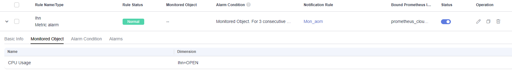

- Click Confirm. Then click View Rule to view the created rule.
As shown in Figure 4, click a rule name to view the rule details.
In the expanded list, if a monitored object meets the configured alarm condition, a metric alarm is generated on the alarm list page. To view the alarm, choose Alarm Center > Alarm List in the navigation pane. In this example, if the CPU usage of the DCS instance meets the preset notification policy, the system will send an alarm notification to the specified personnel by email, SMS, or WeCom.
