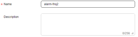

    1. Configure the basic information of the alarm rule.
      Figure 1 Basic information
      Table 1 Parameters for configuring the basic information of the alarm rule
      Parameter
      Description
      Example Value
      Name
      Name of the alarm rule. The system generates a name randomly, and you can change it as you want.
      alarm-b6al
      Description
      Description of the alarm rule. This parameter is optional.

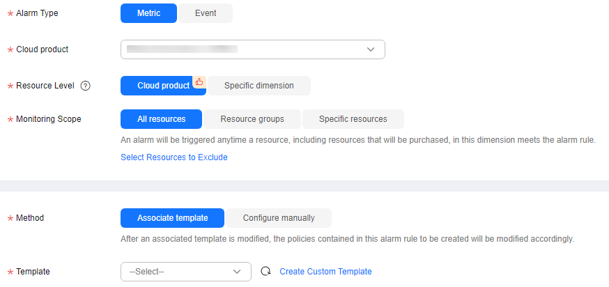

    2. Select monitored objects and configure alarm parameters.
      Figure 2 Configuring alarm rule parameters
      Table 2 Alarm rule parameters
      Parameter
      Description
      Example Value
      Alarm Type
      Alarm type to which the alarm rule will apply. The type can be Metric or Event.
      Metric
      Cloud Product
      This parameter is only available if you select Metric for Alarm Type. You need to select the cloud product you want to monitor from the drop-down list.
      Scalable File Service Turbo - File systems
      Resource Level
      This parameter is only available if you select Metric for Alarm Type. You need to select the resource level of the alarm rule. You can select Cloud product (recommended) or Specific dimension.
      Cloud product
      Monitoring Scope
      This parameter is only available if you select Metric for Alarm Type. You need to select the resource scope that the alarm rule will apply. You can select All resources, Resource groups, or Specified resources.
      NOTE:
      • All resources: An alarm will be triggered if any resource of the current cloud product meets the alarm policy. To exclude resources that do not require monitoring, click Select Resources to Exclude to select resources.
      • Resource groups: An alarm will be triggered if any resource in the group you select meets the alarm policy.
      • Specific resources: Click Select Specific Resources to select resources.
      All resources
      Group
      This parameter is only available if you select Metric for Alarm Type and Resource groups for Monitoring Scope.
      Instance
      This parameter is only available if you select Metric for Alarm Type and Specific resources for Monitoring Scope.
      Event Type
      This parameter is only available if you select Event for Alarm Type. You can select either System event or Custom event.
      System event
      Event Source
      • If you select System event for Event Type, select a cloud service from which the event originates.
      • If you select Custom event for Event Type, specify the event source. Ensure that the event source is the same as that of the reported fields and is written in the service.item format.
      Method
      • Configure manually: If you select Event for Alarm Type and Custom Event for Event Type, only Configure manually can be set for Method.
      • Associate template: If you select this option, any modification made to the template will also be synchronized to the policies of the alarm rule that the template is associated.
        NOTE:
        • When Resource Level is set to Cloud product, only modifications made to the policies of the specified cloud product in the associated template will be automatically synchronized.
        • When Resource Level is set to Specific dimension, only modifications made to the policies of the specified dimension in the associated template will be automatically synchronized.
      Configure manually
      Template
      If you select Metric for Alarm Type and Associate template for Method, or select Event for Alarm Type, System event for Event Type, and Associate template for Method, you need to select a template.
      You can select a default template or create a custom template.
      Alarm Policy
      If you select Event for Alarm Type and Custom event for Event Type, you need to set Alarm Policy.
      If you select Custom event for Event Type, as long as an event occurs, an alarm will be triggered. For example, if the operating status is abnormal, an alarm will be triggered.
      NOTE:
      A maximum of 50 alarm policies can be added to an alarm rule. If any of these alarm policies are met, an alarm will be triggered.
      Alarm Severity
      Severity of an alarm. Valid values are Critical, Major, Minor, and Warning.
      Major

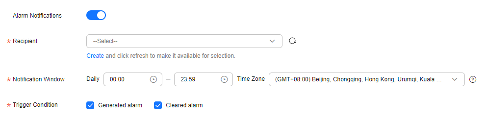

    3. Configure alarm notifications.
      Figure 3 Configuring alarm notifications
      Table 3 Parameters for configuring alarm notifications
      Parameter
      Description
      Alarm Notification
      Whether to send notifications to users over different protocols, such as SMS, email, voice notification, HTTP, HTTPS, FunctionGraph (function), FunctionGraph (workflow), WeCom chatbot, DingTalk chatbot, Lark chatbot, and WeLink chatbot.
      Notification Object
      This parameter is only available if you select Topic subscriptions for Notification Recipient. You can select the account contact or a topic name as the object to which alarm notifications will be sent.
      • Account contact is the mobile number and email address of the registered account.
      • Topic is used to publish messages and subscribe to notifications. If the required topic is unavailable, create one and add subscriptions to it. For details, see Creating a Topic and Adding Subscriptions.
      Notification Window
      This parameter is only available if you select Notification groups or Topic subscriptions for Notification Recipient.
      Cloud Eye sends notifications only within the notification window you specified.
      If Notification Window is set to 08:00-20:00, Cloud Eye sends notifications only within this window.
      Trigger Condition
      You can select either Generated alarm or Cleared alarm, or both.
      NOTE:
      When the alarm type is Event, you can only select Generated alarm for Trigger Condition.
      Alarm notifications sent by SMN will be billed. For details, see Product Pricing Details.
