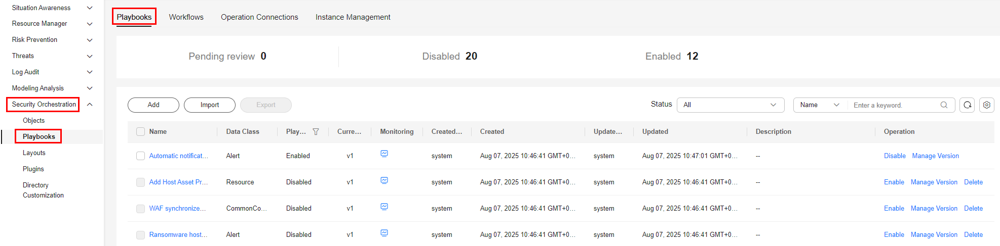

  3. In the navigation pane on the left, choose Security Orchestration > Playbooks.
    Figure 2 Accessing the Playbooks tab
  4. On the Playbooks page, locate the row that contains the Attack link analysis alert notification playbook and click Enable in the Operation column.
  5. In the dialog box displayed, select the initial playbook version v1 and click OK.
