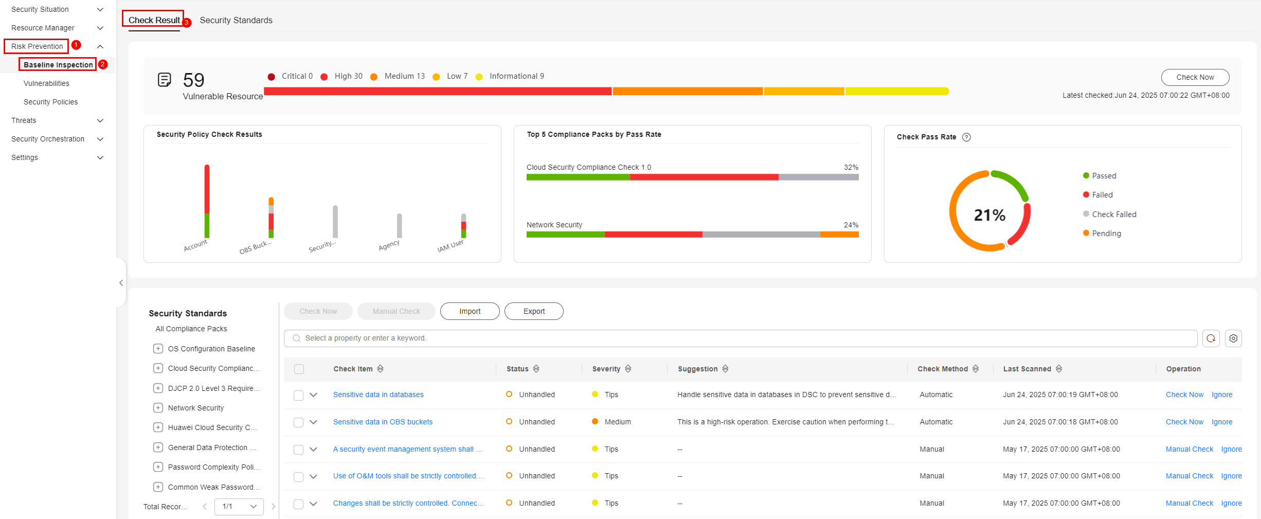

  6. In the navigation pane on the left, choose Risk Prevention > Baseline Inspection.
  7. On the Check Result tab, view the check results of check items. For details about the parameters, see Table 1.
    Figure 2 Viewing baseline check results
    Table 1 Check result parameters
    Parameter
    Description
    Risks By Severity
    Risks found in the last baseline check are listed by severity as well as the corresponding resource quantity.
    Severity: Critical, High, Medium, Low, and Informational.
    Security Policy Check Results
    This graph shows how many failed and passed check items your cloud services have in the last baseline check.
    Security Standard Compliance Status
    This part shows how well your workloads comply with each security standard. You will see a percentage of passed check items in total check items for each standard.
    Check Pass Rate
    Rate of the passed check items in the latest baseline check.
    Check pass rate =Passed check items/(Passed check items + failed check items + check item errors) x 100%. Note that check items not performed are not counted.
    Security Standards and the check result list
    All security standards and check results are displayed.
    • To view the check results of a specific compliance pack, click the security standard on the left. The check result details will be displayed on the right.
    • To display certain columns only, click the setting button in the upper right corner of the check result list and complete the settings (for example, whether to wrap lines and whether to fix the operation column).
    • To view details about a check item, click the name of the check item to go to its details page.
      On the check item details page, view details about description, check process, check result, and checked resources.
