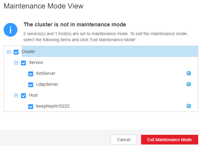

  3. Check the cluster maintenance view.
    On FusionInsight Manager, click or More next to the cluster name and select Maintenance Mode View. In the displayed window, you can view the services and hosts in maintenance mode in the cluster.
    After maintenance is complete, you can select services and hosts in batches in the maintenance mode view and click Exit Maintenance Mode to make them exit the maintenance mode.
    Figure 1 Exiting the maintenance mode in batches
