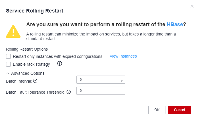

    If you select rolling restart, set parameters listed in Table 1. (Required parameters may vary by version, set parameters based on the actual GUI.)
    Figure 1 Performing a rolling restart on Manager
    Table 1 Rolling restart configuration parameters
    Parameter
    Example Value
    Description
    Restart only instances with expired configurations
    Whether to restart only the modified instances in a cluster.
    The name of this parameter may be different in other versions.
    Enable rack strategy
    Whether to enable the concurrent rack rolling restart strategy. This parameter takes effect only for roles that meet the rack rolling restart strategy. (The roles support rack awareness, and instances of the roles belong to two or more racks.)
    This parameter can be set only when a rolling restart is performed on HDFS or YARN.
    Data Nodes to Be Batch Restarted
    Number of instances that are restarted in each batch when the batch rolling restart strategy is used. The default value is 1.
    • This parameter is valid only when the batch rolling restart strategy is used and the instance type is DataNode.
    • This parameter is invalid when the rack strategy is enabled. In this case, the cluster uses the maximum number of instances (20 by default) configured in the rack strategy as the maximum number of instances that are concurrently restarted in a rack.
    • This parameter can be set only when a rolling restart is performed on some components, such as HDFS, HBase, YARN, Kafka, and Flume. The actual value displayed on the GUI prevails.
    • The number of HBase RegionServer nodes that can be concurrently restarted during a rolling restart cannot be manually configured. It is automatically adjusted based on the total number of RegionServer nodes.
      The adjustment rules are as follows: If there are less than 30 nodes, one node is restarted at a time. If there are less than 300 nodes, two nodes are restarted at a time. If there are 300 or more nodes, 1% of the total node count is restarted at a time.
    Batch Interval
    10
    Interval (in seconds) between restarting two batches of instances during a rolling restart. The default value is 0.
    Setting the batch interval parameter can increase the stability of the big data component process during the rolling restart.
    You are advised to set this parameter to a non-default value, for example, 10.
    Decommissioning Timeout Interval
    1800
    How long (in seconds) a role instance waits to be terminated after being marked for decommissioning during a rolling restart. This parameter can be set only when a rolling restart is performed on Hive or Spark.
    Some roles (such as HiveServer and JDBCServer) stop providing services before the rolling restart. Stopped instances cannot be connected to new clients. Existing connections will be completed after a period of time. An appropriate timeout interval can ensure service continuity.
    Batch Fault Tolerance Threshold
    0
    Tolerance times when the rolling restart of instances fails to be batch executed. The default value is 0, which indicates that the rolling restart task ends after any batch of instances fails to restart.
  5. After the restart or rolling restart of a component is successful, Running Status of the component is Normal and Configure Status is Synchronized.
